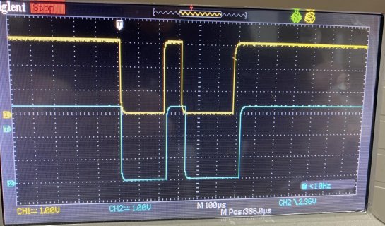

I was trying to use FlexSerial to replicate a UART for MIDI Output. Unfortunately, I'm hitting some roadblocks. I'm not able to manipulate the baud rate for the FlexIO pin. begin(31250) should work, but the pin is still sending the MIDI message at a baud rate of 115200.
Photo above comparing the FlexIO pin (yellow) vs a Serial TX pin running at 31250baud (blue) and both writing the same bytes. I've looked at the code in FlexSerial.cpp and compared it to the IMXRT manual chapter 50 and the flexio configuration code looks fine. Adjusting the FLEXIO1_CLOCK value somewhat changes the speed but I am not able to determine a relationship between that and the baud rate.
Any idea where I should be looking at?
Ah yes, double. Getting close but something still isnt quite right.
I tried to half the FlexIO clock speed by using the divider
  CCM_CS1CDR &= ~( CCM_CS1CDR_FLEXIO2_CLK_PRED( 7 ) );
  CCM_CS1CDR |= CCM_CS1CDR_FLEXIO2_CLK_PRED( 0b11 );
And its close to 31250 now, but still not quite. More like 34500.

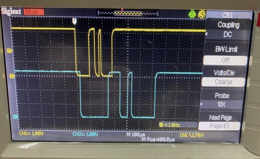

Blue is MIDI TX from Serial1 running at 31250.
Yellow is from the FlexIO pin.
EDIT** Resolved! I just had to divide the clockrate (FLEXIO1_CLOCK) in FlexSerial.cpp as well.

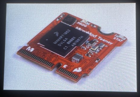

Now my last challenge is to understand why the image comes though a bit fuzzy and offset to the right when I use the polling method.
Top half is interrupt transfer, offset and fuzzy. Bottom half is polling and is crisp and clear.

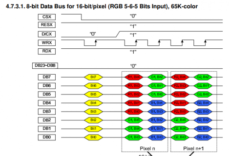

Interesting, is this some FlexIO3 weirdness or is it the same 16-bit word swap issue that we had issues with in September 2021 in this thread?
Is the same issue we had back in Sept 21..
Back then you whipped out some dark magic and got it running by loading the data in from end to start and swapping half words with the DMA engine.
Basically when you fill the shifter buffer with 32 bits it will start at the last 8 bits (bit 26), and decrement by 8 bits at a time until bit 7 for the last byte of data to be sent out.
So it gets sent out in reverse from how it came in.. god knows why it was designed like this
It's not FlexIO doing anything wrong, it outputs the bits from the shift buffer starting with the lowest through to the highest. The problem is the ILI9488 expects the upper byte (of each 16 bits) to be received first:
Interesting observation! I've seen that image tens of times yet never actually payed attention to what was in it..
I guess there's no way on the ILI9488 to overcome this based on the brief search I did in the 9488's datasheet
