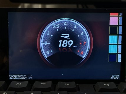

Hey mate!
I've got a custom Teensy MM dev board with all 32 FlexIO2 pins exposed!
Was wondering if you could help me modify the DMA config to accept also 32 bit data array input and output 24 bits for RGB888 support? I'm quite rusty with my DMA knowledge these days :D
This means that there will be wasted 8 bits per shifter but im not really worried about that..
Sure, do you have it working with polling or interrupts already?
You will probably want to have each pixel stored in one 32 bit word in memory (24 bits of data and 8 bits of padding) to work most effectively.
Can you share a RGB888 version (non-DMA)? Not sure how the data is arranged in memory...

I would think it can be much simpler with 32 bit formatted data... If you just write p->SHIFTBUF[0] = argb888Value, does that work?
If you set FLEXIO_SHIFTCFG_PWIDTH(23) it should shift out 32 bits at a time, ignoring the upper 8 bits (alpha value).
Yeah its seems to work in polling mode by just feeding the shifter buffer with pointer to the frame buffer, no masking applied.
Now, how do I set up DMA to do that? I dont need to swap and bytes or half words around this time, so should be simpler
Try this code... I modified your library's FlexIO_Config_MultiBeat, MulBeatWR_nPrm_DMA, and flexDma_Callback. You will need to update the single beat configuration for 24 bit PWIDTH and other stuff. In the header, you need to change MulBeatDataRemain from type uint16_t* to uint32_t*. I don't have a way to test this currently but hopefully it works.

I've been playing with Polling for now, and while I am facing some issue with artifacts on the screen and some colors being off, 24 bit color does look so much better!
It seems to be working in a nutshell..
But something is way off with this display or my code haha
I gotta say though, it looks real good at 24 bit color depth and it's fast with the 24 bit bus!
Check you have all the parallel wires connected to the right pins... Or maybe try replacing SHIFTBUF WITH SHIFTBUFBYS, SHIFTBUFBBS, or SHIFTBUFBIS and see if that looks better.
I think that there might be interference with the wires. As I have tested all the pins and they seem to work fine.
It could also be missing some register settings in the display. I'll investigate.

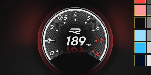

For reference, here is the original image that is being displayed:
