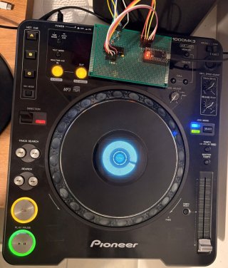

I've come back to the slave SPI stuff as I now have a newer CDJ panel that is configured as an SPI master
It has four wire setup which is wired to SPI on my T4.0
I've been playing around with tens of sketches using Claude generated code and no matter which version I use (Claude or yours)
If I disable the TX DMA channel (eg it does not trigger at all) then the RX data stream is stable, and all the data is present.
As soon as TX DMA channel is enabled, that's where things get messy as I had experienced before.
Even more, on simple polling or interrupt driven Slave, as soon as I load data into the TDR register, it does the same thing. But if I don't touch it, the RX data stream is fine.

Master is a CDJ1000 mk3 panel
Mode3. MSB first. 27 byte long frame.
4 wires in total: MISO, MOSI, CLK and CS between 7-10cm long. I can't go any shorter.
Wired to SPI on the T4 via a logic level converter as the CDJ is 5v logic
CS->10 , MOSI->11, MOSI->12, SCLK->13

Looks like it reports many more bytes received than what your master sent. Strong hint that your SPI clock signal at the slave input really sees more than 27*8 edges. And thus registers more bytes received while the CS was low.
As it depends on what’s in the TX buffer, it may well be the case that edges on the SPI slave SDO line get coupled back into the SPI clock line.
Try tying the GND connections on master and slave together in a ground plane fashion. The leads you used look like poor quality and long. Check ohms of each wire, end to end.
The logic level converters may also cause trouble. Caps on both 5V and 3V power rails? Circuit diagram?
If you have a good scope ( >= 500 MHz) then look at how the GND pin on the Teensy differs from the GND on your SPI master. Because that GND wire is too long, too high ohms, or picking up edges from nearby digital lines. And look at how SDO edges end up causing double clock edges when master sends out just one edge.
This is the level shifter I used (but from AliExpress) and while I can read packages, Its not sending them nicely
But, I did get the components today to build out a logic level shifter based on the 75HC245, but the pullups were wired idividually to 5v, and the buffer's vcc and control pins to 3.3v
I measured the B side to make sure I was getting 3.3v
I spent a few days using your codebase and experimented with Claude and got it to work very well
Wires are +10cm to the HC245, then another 10cm wires to the Teensy
All RXing and TXing is stable
