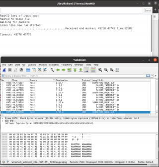

  Serial.println(F("RawHID lots of input test"));
  rx_size = RawHID.rxSize();
//  rx_size = 64;
  Serial.printf("RawHid RX Size: %d\n", rx_size);
  em = 0;
  Serial.println(F("Waiting for packets"));
  int n;
  n = RawHID.recv(buffer, 0); // 0 timeout = do not wait
  if (n > 0) {
    packet_count++;
    digitalToggleFast(13);
    // check Serial numbers
    uint32_t packet_number = 0;
    for (int i = 0; buffer[i] >= '0' && buffer[i] <= '9'; i++) {
      packet_number = packet_number * 10 + buffer[i] - '0';
    if (packet_number == 0) {
      Serial.println("Looks like new run started");
      last_packet_number = 0;
      packet_count = 1;
      emTotal = 0;
    } else if (packet_number != (last_packet_number + 1)) {
      Serial.printf("Missing? cnt: %u, Last: %u cur:%u\n", packet_count, packet_number, last_packet_number);
    } else if ((buffer[8] != buffer[rx_size-2]) || (buffer[rx_size-1] != '\n')) {
      Serial.printf("msg format error: %u\n", packet_count);
    if (buffer[7] == '$') {
      Serial.printf("Received end marker: %u %u Time:%u\n", packet_count, packet_number,
        (uint32_t)emTotal);
    last_packet_number = packet_number;
    run_active = true;
    em = 0;
    if ((packet_count & 0x3ff) == 0) Serial.print(".");
    if ((packet_count & 0xffff) == 0) Serial.println();
  } else if (run_active && (em > 1000)) {
    Serial.printf("\nTimeout: %u %u\n", packet_count, last_packet_number);
    run_active = false;

I have included here update Rawhid host download, which is my WIP including above program. Note Makefile updated to build this one instead of main example.
Does this make a difference?
Well the example sketch tries to upload logically a 22mb file. With normal Rawhid this takes about 88 seconds, converting to 512 this now takes < 11 seconds. As expected 8 times faster.

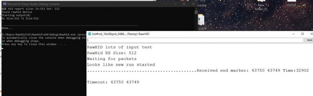

Quick update: Mostly talking to myself ;) I was able to get the Windows version to build now :D
I have it building two different ways:
By the Makefile in an Ubuntu on Windows which looks like it is running 18.04...
Note: I had to edit both sources and makefiles. The i586...ming32 stuff needed to be replaced by the ming64 stuff:

I was this morning also able to build it now using VS 2019 after installing SDK and WDK. I don't have a very clean project file, but it worked... It does run, I have not tried plugging in board yet to see if the new windows one will see the hid device.

Tested on windows, that it could run with the hid test program here. in either 64 or 512 byte packet sizes...
Finally got done with my chores and updated cores, sketch and VS project. Did have to update Linker Input to add hib.lib and setupapi.lib as well as changing the hid.h path in SendALot.cpp. But it worked at 512:

Seems to be building ... not as far as knowing what is going on yet:
C:\T_Drive\tCode\pjrc_latency_test\RawHid\VS\RawHid\x64\Debug>RawHid.exe
$$$ Hid report sizes In:513 Out: 513
found rawhid device
Starting output(0)
Rx Size:512 Tx Size:512
Done...

Update: TyComm doesn't get the 'Serial.print' from the sketch - but T_sermon does:
RawHid RX Size: 512
Waiting for packets
Missing? cnt: 5, Last: 9165 cur:3
TyComm 'connects' - but that output was buffered and showed up when T_sermon was opened.
Output is after it completed the 'Done' pass - then after a wait ( maybe the 5 missing? ) I restarted the EXE.

Quick update:
I now have it working reasonably well with USBHost talking to the Rawhid or Rawhid 512. Updated the HID class to detect the size of the rx and tx pipes...
enhanced the HID calls to allow the hid object that claims it to provide external larger buffers, now up to 4 of them for rx and tx...
Sketch also talks using the seremu code in USBHost... Fixed a seremu bug... Sketch detects if SerialUSB1 exists.. if so forwards to it...
Right now does the send a large index file like data to the other test sketch...

SerialUSB1:
RawHid RX Size: 512
Waiting for packets
..........................................Received end marker: 43750 43749 Time:32888
Timeout: 43750 43749
Not as fast as talking to PC, may check to see the timing settings...

Today I played a little more with the Rawhid stuff to see if I can make it work closer to the MTP transfer code to see if I could replicate maybe losing messages.
One main difference is RAWHID uses interrupt transfers and MTP uses bulk transfers... So hacked up another variant of the RAWHID that uses bulk transfers...
So hacked it pushed up a cores branch rawhid_512_bulk that had another USB type...
boards.local.txt
teensy41.menu.usb.rawhid512=Raw HID 512
teensy41.menu.usb.rawhid512.build.usbtype=USB_RAWHID512
teensy41.menu.usb.rawhid512.fake_serial=teensy_gateway
teensyMM.menu.usb.rawhid512=Raw HID 512
teensyMM.menu.usb.rawhid512.build.usbtype=USB_RAWHID512
teensyMM.menu.usb.rawhid512.fake_serial=teensy_gateway
teensy40.menu.usb.rawhid512=Raw HID 512
teensy40.menu.usb.rawhid512.build.usbtype=USB_RAWHID512
teensy40.menu.usb.rawhid512.fake_serial=teensy_gateway
teensy41.menu.usb.rawhid512B=Raw HID 512 Bulk
teensy41.menu.usb.rawhid512B.build.usbtype=USB_RAWHID512B
teensy41.menu.usb.rawhid512B.fake_serial=teensy_gateway
teensyMM.menu.usb.rawhid512B=Raw HID 512 Bulk
teensyMM.menu.usb.rawhid512B.build.usbtype=USB_RAWHID512B
teensyMM.menu.usb.rawhid512B.fake_serial=teensy_gateway
teensy40.menu.usb.rawhid512B=Raw HID 512 Bulk
teensy40.menu.usb.rawhid512B.build.usbtype=USB_RAWHID512B
teensy40.menu.usb.rawhid512B.fake_serial=teensy_gateway
I then also hacked up my rawhid project, hid code so far on linux to detect it is BULK and use the bulk api instead of the interrupt api...
So far only on write.
Plus updated the test sketch to detect it and then try to send 32 packets at a time...
Appears to be working... Not seeing any lost packets yet.

@KurtE - This is so strange:) I have been playing with the same library this weekend. I have two Teensy's connected together. One is loaded with "Basic.ino" and is connected to the USB host port on the second T4.1 which is loaded with "RawHIDtoUSBHostRawHID.ino". Then I used "rawhid_test" which worked well as a pass through. I downloaded RawHID again from your GitHub which was two hours old. Hopefully I can play with it a little tonight.
I really am interested in being able to use rawhid with USBSerial bidirectionally between two T4.1's at 480MBs... (Is MBS right):)
Mbs - meg bits/sec
Did a RawHID echo through USBHost and it worked well. Host was running QEthernet UDP Chat that worked well ...
