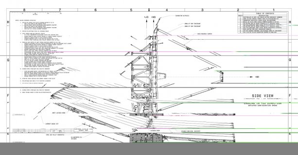

Anyways I downloaded the latest and greatest changes you made and tried transferring a 4.8mb jpg.
The sketch says it transferred the file successfully:
 bytes:#################### Exit Download main Loop ##########################
lsrhid: 8 0x20057e64 4 1000
.(4810864)
Remote Send File Completed
Completed, total byte: 4810864 elapsed millis: 223547
and when I did a LD it shows correctly:
JWST-SideView.jpg * * * * * * * * * *C: 05/08/2023 14:21 M: 01/01/2022 08:51 *4810864
but when put back in the directory shows only 4.7 MB and if I open the file you can see that it missed transferring some the image.
oh and after the transfer I tried to do a 'd' remote directory and that didn't work.
Here is scaled down version of the transferred image - think its clear there were transfer issues:

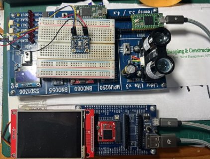

NOTE: For host I am using a Teensy Micromod with a Teensy 4.1 via the USBHost connector.

Did some more testing with that one jpeg that showed issues with uploading and downloading with MTP enabled.
Found that if you just comment out the mtp_loop command in the upload/download functions transfers were successful and degradation of the image occurred even with debug still enabled. In this way you can still use MTP at least on the host.

As a test I decided to see what would happen if I used a T4.0 as a sensor hub and then send the data via RAWHID. First I pulled out the old sensor board that we used for I2C testing using just the BNO080 and the onboard lidar and added a MPL311x pressure sensor via the QWIIC connector. Second I used the simple approach of putting the data into a structure and then sending it out via RAWHID to a TMM. Here is a quick photo of the setup.
The sketch does not add any delays so it is sending data as fast as possible, in this case the major driver is the pressure sensor since I am using a oversampling rate corresponding to about 38ms. Yes I know i can do things to make it faster before you ask. Here is the sensor hub sketch:

Just with this quick test seems to be keeping up with the xfer's with no issue:
type, timestamp (miilis), roll, pitch, yaw, altitude, pressure(pa), temperature
1, 6439, 177, -1.895981, -0.504256, -66.783936, 0.000000, 101258.250000, 77.562500
1, 6492, 178, -1.905749, -0.502355, -66.787788, 0.000000, 101258.000000, 77.562500
1, 6544, 178, -1.901901, -0.508194, -66.787704, 0.000000, 101256.500000, 77.562500
1, 6597, 175, -1.901901, -0.508194, -66.787704, 0.000000, 101266.500000, 77.675003
1, 6650, 175, -1.901901, -0.508194, -66.787704, 0.000000, 101263.500000, 77.562500
1, 6703, 175, -1.902129, -0.507186, -66.727585, 0.000000, 101253.250000, 77.449997
1, 6755, 175, -1.896288, -0.503341, -66.727676, 0.000000, 101265.250000, 77.562500
1, 6808, 175, -1.896288, -0.503341, -66.727676, 0.000000, 101264.500000, 77.562500
if I don't use the pressure sensor:
1, 14234, 173, -1.875804, -0.643529, -66.038666, 0.000000, 0.000000, 0.000000
1, 14239, 175, -1.875899, -0.643454, -66.032799, 0.000000, 0.000000, 0.000000
1, 14243, 175, -1.875899, -0.643454, -66.032799, 0.000000, 0.000000, 0.000000
1, 14248, 175, -1.875899, -0.643454, -66.032799, 0.000000, 0.000000, 0.000000
1, 14253, 176, -1.875899, -0.643454, -66.032799, 0.000000, 0.000000, 0.000000
1st case about 50ms between packets, second case about 5ms.
