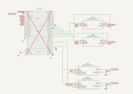

@DD4WH
I mocked up a T-DSP Mic Array Module that should cover your use case.
The design uses two TAC5212 codec modules:
• TAC5212 #1: 4 PDM mics (2 per data line via SELECT pin)
• TAC5212 #2: 2 PDM mics + 2 Knowles SPM0687LR5H-1 analog MEMS mics on the differential inputs
The 6 PDM mics sit in a circular array (50mm diameter, ~26mm spacing) for beamforming, while the 2 analog MEMS mics are positioned as a stereo pair in the center for low-noise stereo capture — 70dB SNR, 130dB AOP.
The board has a Teensy 4.1 footprint for standalone operation and a T-DSP expansion header for integration with the Desktop Pro or other mainboards.
Very hacked together, but the concept is there: https://github.com/t-dsp/t-dsp_mic_array_module
Let me know what you think.

@JayShoe
Wow, I am really impressed! ... and also a little embarassed to see you do that much of development work just because I mentioned "two future projects" I was thinking about in a forum post . . . thank you for all your hard work!
However, I feel overwhelmed with such a complex hardware project and I think it is well above my capabilities, both in hardware (designing 8-layer custom PCBs from your design) and software (getting PDM to work with the TAC5212). And it is also that my spare time for this kind of hobby is rather limited.
So, thank you once again!
