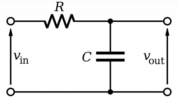

I'm trying to switch from 328p to teensy hardware for my APRS tracker with speech. In short, the tracker provides spoken information on position and altitude using the Talkie library. In addition, an APRS message is constructed with the help of a mx614tn modem chip. Both audio message are sent consecutively to the audio input of a transmitter.
Unfortunately, the 62.5Khz block wave of the Talkie signal frustrates the APRS message which comes later. Previously, I was able to stop the Talkie block wave in the Github/idhanu/Talkie version using the voice.end(); command. Subsequently, I switched the talkie audio pin to INPUT, to give the pin a high Impedance.
A method for killing the block wave after the Talkie message is therefore what I need.

Thanks for the info. Appears to be not so simple to cut the 62.5khz block wave on a Teensy. Decided to go for the hardware solution.
A simple low-pass filter using a 4k7 resistor and a 15nF capacitor did the trick (image taken from wikipedia). The resulting 2.2khz cut-off frequency effectively filtered out the 62.5kHz block wave without affecting the sound quality of the Talkie voice.

Nice that worked as expected. The code wouldn't be hard to change - just some #ifdef stuff in the way and then testing the cases …
It might even make sense to stop the timer anytime the queue goes empty - stop the noise and wasting cycles for nothing.
