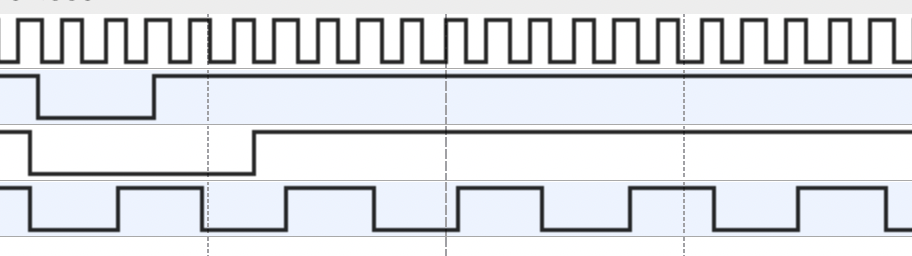

Hi everyone,
i'm also trying to replicate it on a breadboard but i cannot manage to get any signal on OS pin. I've checked the clock signals with a logic analyzer and all seem to be good. All values i'm reading are at 3600.
Is it possible i got a faulty sensor?
@Madaeon: what did you change to get it running?
BRs,
Sem
Any Idea why i cannot read any values?
Is anyone willing to help me here?
Most assuredly @SamMoo … problem is it would have someone with the hardware at hand like the prior two posters on this year+ old thread.
> Or enough details / context /specifics to inspire and entice someone to understand the problem enough to get toward a solution.
Perhaps in reviewing the prior post details and presenting your own the missing piece will become apparent.
You are showing four signals, but the CCD takes only three.
I'm looking at the 3rd figure in your post, and assuming your four signals are (from the top)
MCLK (looks ok, I can't read the frequency)
SH (polarity is reversed and the delay from the falling edge of ICG is not long enough)
ICG (looks ok)
4th unknown, not sent to the CCD
Also I cannot see the frequency (or period) of ICG vs SH. The periods must obey this relation ICGperiod = n·SHperiod, and ICGperiod > 7,4 ms (assuming MCLK = 2,0 MHz) and SH > 10 µs
As reim suggest, try with very low values for the SHperiod. The chip is quite sensitive. In a normally lit room I see saturation with an SHperiod of app. 100-200 µs

  // resets the pixel count before ICG goes high to signal new frame
  FLEXPWM2_SM1STS = 1;  // clear interrupt flag for sm 0
  count = 0;
  while (FLEXPWM2_SM1STS == 1); // wait for clear
void setup_SH() {
  //IOMUXC_SW_MUX_CTL_PAD_GPIO_B1_01 = 6; // set pin 7 to be PWM1 B SM 03
  IOMUXC_SW_MUX_CTL_PAD_GPIO_EMC_06 = 1; // set pin 4 to be PWM A SM 0
  FLEXPWM2_SM0CTRL2 = FLEXPWM_SMCTRL2_INDEP | FLEXPWM_SMCTRL2_WAITEN | FLEXPWM_SMCTRL2_DBGEN;
  FLEXPWM2_SM0CTRL2 |= 128; // set force enable
  if (ES == 1) FLEXPWM2_SM0CTRL = 112; // set prescaler to 128
  if (ES == 2) FLEXPWM2_SM0CTRL = 96; // set prescaler to 64
  if (ES == 4) FLEXPWM2_SM0CTRL = 80; // set prescaler to 32
  if (ES == 8) FLEXPWM2_SM0CTRL = 64; // set prescaler to 16
  if (ES == 16) FLEXPWM2_SM0CTRL = 48; // set prescaler to 8
  if (ES == 32) FLEXPWM2_SM0CTRL = 32; // set prescaler to 4
  if (ES == 64) FLEXPWM2_SM0CTRL = 16; // set prescaler to 2
  // SH occurs 128 / SH_PRSC times during one frameout cycle, i.e. 1, 2, 4, 8, 16, 32, 128 times
  // could happen more times but would have to change val1
  FLEXPWM2_SM0CTRL |= 2048; // reload on half count (actually reloads immediately since val0 is set to 0)
  FLEXPWM2_SM0OCTRL = 0; // output control register, bits 10 and 9 are A, B polarity
  //FLEXPWM2_SM0OCTRL |= 1024; // set A polarity to 1, should swap high and low
  FLEXPWM2_SM0DTCNT0 = 0;
  FLEXPWM2_SM0INIT = 0; // set counter initialization to 0
  FLEXPWM2_SM0VAL0 = 0;
  FLEXPWM2_SM0VAL1 = CNTPF - 1;
  FLEXPWM2_SM0VAL2 = CNTPF - ES*CNT_ICG + off;
  FLEXPWM2_SM0VAL3 = CNTPF - ES*CNT_ICG + off + CNT_SH; // pulse SH high for CNT_SH counts
  FLEXPWM2_SM0VAL4 = 0;
  FLEXPWM2_SM0VAL5 = 0;
  // 0000 0100 0000 0000
  FLEXPWM2_OUTEN |= 256; // set output enable for A, module 0
void setup_MCLK() {
  IOMUXC_SW_MUX_CTL_PAD_GPIO_B0_10 = 2; // set pin 6 to be PWM2 A SM 02
  FLEXPWM2_SM2CTRL2 = FLEXPWM_SMCTRL2_INDEP | FLEXPWM_SMCTRL2_WAITEN | FLEXPWM_SMCTRL2_DBGEN;
  FLEXPWM2_SM2CTRL2 |= 128; // set force enable
  // I'll set prescaler to 64 such that the min frequency is 150e6/2^16/16 = 35.8Hz
  // CTRL = 0000 0100 0110 0000
  FLEXPWM2_SM2CTRL |= 2048; // reload on half count
  FLEXPWM2_SM2OCTRL = 0; // output control register, bits 10 and 9 are A, B polarity
  FLEXPWM2_SM2DTCNT0 = 0;
  FLEXPWM2_SM2INIT = 0; // set counter initialization to 0
  FLEXPWM2_SM2VAL0 = 0; // set VAL0 to be halfway through counter??
  FLEXPWM2_SM2VAL1 = CLKPMCLK - 1; // each clock tick is 2/3us with 16x prescaler
  FLEXPWM2_SM2VAL2 = 0; // for now, no phase shift
  FLEXPWM2_SM2VAL3 = CLKPMCLK/2; // pulse ICG low for CNT_ICG counts
  FLEXPWM2_SM2VAL4 = 0;
  FLEXPWM2_SM2VAL5 = 0;
  FLEXPWM2_OUTEN |= 1024; // set output enable for A, module 2
void setup_ADCCLK() {
