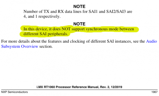

I'm afraid page 1967 in the reference manual has some bad news.

I have seen that on the datasheet it is not possible that they can be in sync, but with further search, i have found this document - https://www.nxp.com/docs/en/application-note/AN12090.pdf .
In the datasheet under the SAI section - i.MX RT1060 Processor Reference Manual, Rev. 2, 12/2019 p. 1973 - they indicate that it´s possible to run each SAI synchronized to each other.
My idea was to make 2 of the SAI channels as slave and connect them on the same master - with wires - if it makes sense since they will have the same master they would be in sync.

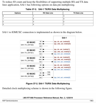

I have read further on the datasheet. There are 4 transmitters and 4 receivers that can be routed to 5 I / O 'cords' via an option register. It can then be set up as e.g. 2 x TX and 3 x RX.
Each TX string can then carry a frame of 16 16 bit words. That is a total of 32 x 16 bit audio with a bit clock of approx. 11.3MHz (MCLK 22.6MHz)
Similarly, there may be room for 32 x 16 bit channels RX on two of the remaining cords.
Document Number: IMXRT1060RM Rev. 2, 12/2019
page 1963

in my opinion you can use up to 4 data ports (call it channels) for SAI1 and drive up to 4 DAC's synchronously.
That is also my intention right now. I will try to run 2 TX data lines through an SAI - that way they will have the same clocks. Thanks for your input!
What would stop you from configuring TDM2's Frame Sync Direction to externally generated then running a wire from TDM's WS signal into TDM2's WS signal so that they share the same frame sync timing?
It was also my intention until I discovered that the SAI-1 has 4 TX of 4 RX "cords" which can be set up as desired. That's what I want to try now. Thank for you input! :)
