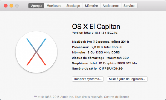

Theremingenieur - you have /'d path - is that linux or mac?
TYQT Rocks - puts SerMon to shame and the added hex upload without re-compile and the GUI reset and 'multi Teensy GUI directed upload' just puts some great icing on the cake that is Teensy. If it tied into "Upload Drop USB on Com#" to auto direct the flash it would be worth twice the price!
I'm on Mac:
