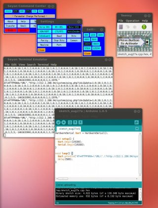

I tried to reproduce this problem. Obviously I can't run that large program as-is, because I do not have this particular Arduino shield.
So I tried to do the best I could with the info and code you provided. I copied that long print line into a minimal program. I removed the extra spaces. The exact code I used for testing is attached below.
I connected pin 3 on the Teensy++ to the RX pin on a FTDI TTL-232R-3V3 cable, and of course I connected their grounds together. I ran the Seyon terminal emulator to view the data as received by the FTDI cable.
As you can see in this screenshot (click for full size), the FTDI cable receives the entire string.
I'm not sure what else I can do to try to help. Any ideas?

I do not know. This simple test seems to suggest the transmission is ok, but it's entirely possible there's a subtle bug causing corrupt transmission with that more complex program. I simply do not have enough info to really guess where the problem is.
I can try to connect the tx/rx to arduino and check what it receives..
Can you use Serial.end() on the Arduino board, so it's USB chip works similarly to the FTDI cable? Then you can use it to just listen to Teensy++ -> modem signal.
I am using 1.0.4, do you think that might be the problem?
by the way, what buffer do you use? (rx/tx buffer for the hwserial)
I'm using Arduino 1.0.5 with Teensyduino 1.15 installed.
I tested with the code attached to message #6 above. I used this TTL-232R-3V3 cable.

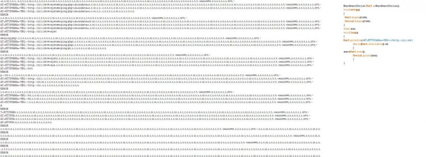

I tried a simpler program, with same setup, both code and serial window in the following image fE1as6o.jpg
I think the problem might lay with the rx buffer of the teensy? what do you think?
by the way, thanks for all the help
In the image it is shown that every other 3rd or 4th "request" in cut in the middle, at random places.
the code itself sends the long query and reads the response. thats all.
also, something a bit interesting, whenever I added a delay after the trasmit it screwed everythings up, when I put it after the "while" loop that reads everything (actually at the end of loop() ) it always cut the string, and always in the same place,
