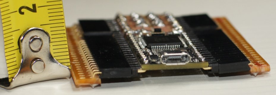

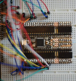

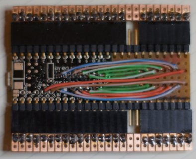

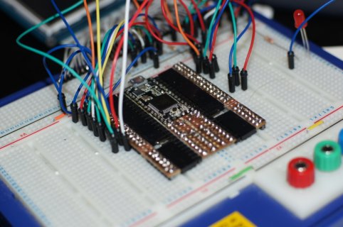

I've got wires soldered to those pads underneath and brought out to pins that I've then breadboarded
It really shouldn't matter for the lengths involved. Wire size should only matter in two situations. Long wiring runs, or dealing with significant amounts of current. The latter is mostly irrelevant, since the teensy itself isn't capable of sourcing significant amounts of current, and shouldn't be used as such. For most projects, wire length isn't going to be an issue either, since most sensors, displays, etc, are going to be within six inches of the teensy anyway. For general purpose use, I probably wouldn't go below 26 gauge, but like I said, it's not that critical and most likely anything you have laying round will be larger than that, which is fine.

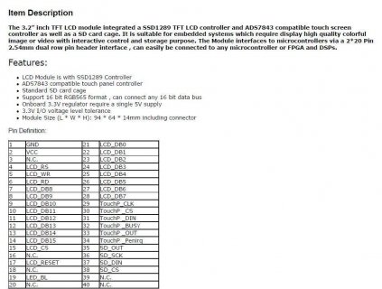

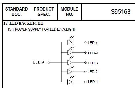

Now to my current question. Received my TFT displays and I am now trying to get them going with little success in the first couple of hours. This is a question for Dawnmist and Qumefiox really, what model are you using in UTFT for the TFT display with the SSD1289?
As far as I can see there are 4 options:
ITDB32S
TFT01_32
INFINIT32
GEE32
Anyone having issues using setColor(?, 0, 0); ?? it seems red is having issues at least on my 32WD tft. I can fade in blue and yellow no problem, but when I try red.... it seems the values are not working correctly on red.
the above works fine for fading yellow on and off on text, however the second I try to use red I get erratic on and offs. Example would be (60,0,0) is moderately on however (130,0,0) is damn near off on my screen.
There is a model name "SSD1289" (as per page 3 of the supported displays pdf included in the library's files).
My initialization is:
and then everything else matches what you've got above.Code:uint8_t lcdRS = 19; // Register Select uint8_t lcdWR = 18; // Write //uint8_t lcdRD; // Read - Unused uint8_t lcdCS = 17; // Chip Select uint8_t lcdReset = 24; // Reset UTFT screen(SSD1289, lcdRS, lcdWR, lcdCS, lcdReset);

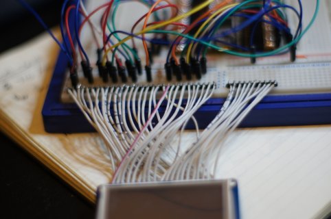

Other things to check:
1. Is the screen's backlight connected to power? I've usually had it connected to an analogue pin on the teensy so I could control it, but it needs to be given ~3.3v power for full brightness.
2. Check the data pin connection order carefully - make sure you haven't reversed/inverted it by mistake.
Which particular screen did you get? Any links to the screen's specs? Photo of the wiring connections?
