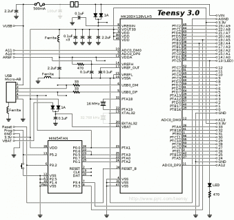

The Teensy 3.0 schematic is (finally) available now. :)
http://www.pjrc.com/teensy/schematic.html
Edit: this old schematic (posted November 2012) has a small error near the VUSB pin. Please use the schematic from the main website.
Thanks, Paul. What is the 1A dual diode-looking component? From the schematic I would assume that's a voltage regulator? Whatever it is, I think I've blown it somehow while running on external power...
It is a dual diode. I'd assumed it was a voltage regulator, but the schematic shows it's a dual diode used in parallel, and the 3.3V regulator is actually contained within the main ARM cpu (+5V goes through diode into VREGIN pin).
That is marked as a 1 A part and the Teensy does not use nearly that much current, so I'd be curious how it could be blown- unless by very high reverse voltage above the breakdown limit, but that would very likely kill the CPU also.
Thanks, and yes I'm not sure what I could have done either. It seemed to suddenly die when I was working on the software side of things and now I'm not able to detect it over USB, though it is powered externally.
Yes, it's a 500 mA PTC "fuse", which it sometimes called a "poly fuse". It's the tall white part near the USB connector.
The 1A diode is a dual schottky diode. Even though the expected current is much less than 1 amp, I wanted to keep the voltage drop across the diode small for people who want to run from a 3.7 volt battery.

Paul, you mentioned in an earlier post that there was reverse polarity protection when powering via Vin, which I see from the dual parallel diodes. But will reverse polarity applied to 3.3v harm the Teensy 3.0? Or is that also internally protected with circuitry inside the chip?
One follow up question, then, regarding reverse polarity: what is the function of the parallel diodes between VBAT and the chip's VBAT and VIN -> VREGIN? Do they provide any sort of protection from reverse polarity on VIN and VBAT?
I ask because I'm planning to make very simple devices that other people in my office will be using, frequently when I'm not there to remind them to connect batteries in the correct polarity. And despite all the physical obstacles that one could introduce (e.g. tabs on the battery holder), I'm sure someone will find a way to reverse + and -. I just want to know if doing so will fry the Teensy and require me to add protection circuitry or if I'm OK as is.
The diodes on VBAT allow the 3.3 volt power to automatically power the VBAT pin, but the battery provides power as soon as the normal voltage drops lower than the battery voltage (presumably a 3.0 volt coin cell). When the coin cell is powering the real time clock (VBAT pin), current can't flow back into the main 3.3 volts because of the other diode. Likewise, the 3.3 volts can't attempt to charge the coin cell when the battery's voltage is less than 3.3 volts.
Yes, the diodes do protect against reverse polarity. It's safe to connect a battery that may be installed backwards to VIN or VBAT.
But it is not safe to allow reverse polarity when connecting directly to 3.3 volts. If you try to power the whole board that way, for example using a pair of AA or AAA batteries between 3.3V and ground, you must use battery holders that mechanically prevent reverse polarity connection. Here's one:

One wish - it looks like PTA0 ... PTA3 are completely masked behind the Mini54. Is there any way to expose them to the outside world for external ARM-JTAG or ARM-SWD programming? (using some fine soldering work perhaps?). Would the Mini54 withstand this type of treatment? :)

or add a diode in reverse across the battery inputs (e.g. 1N4001, 4002, 4004 etc -- any one will do) if using AAA, or 1N5401 (5402, etc.) if using AA. This will short the battery if it is connected in reverse, so the battery will run down, but the Teensy won't get damaged. Don't do this if you are using larger or rechargeable batteries as the current would be too high.

My first question is about the 3.0. I looked at the schematic, and was wondering what the auxiliary processor (MINI54TAN) is for?
In a nutshell, the Freescale ARM chip lacks a hardware bootloader feature. The other chip controls the boot process, so you get a very familiar development process. It also does this without consuming any flash memory on the main chip, so your program can use the whole memory.

That's a technique I use frequently, but with two important enhancements:
1. I always put some kind of over-current protection (polyfuse, etc) in the feed to the circuit, ahead of the reverse diode, which eliminates a flame-out if a low-impedance power source is accidentally connected backwards.
2. Using a Zener in place of the 1N400x diode, oriented the same way (cathode to +) buys you over-voltage protection, in addition to reverse-polarity protection. Much more bang for the buck that way! Be sure you know how Zeners work, and pick a sensible breakdown voltage that ensures the diode won't turn on at your intended operating voltage!
That's what us old-timers used to call a "Crowbar" protection circuit.
Alternatively, since PTA0 .. PTA3 are all the JTAG pins, couldn't the Mini54 be made into a JTAG frontend?
Based entirely on how it's connected: Couldn't that be how the Mini54's programming the K20 anyway? *that* would be an awesome process to get a look inside.
