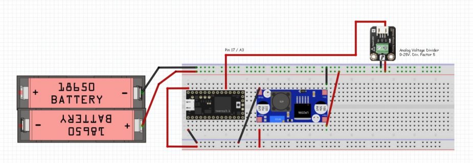

Thank you guys, this is my simple setup.
The battery is 2x 18650 = 8,4V
I'm aware of the possibility of averaging the analogRead() results. But i want to clean the noise with hardware first as good as possible.
The components i used are these :
Step Down Converter
Voltage Divider 5x
pinMode(A3, INPUT);
int V = analogRead(A3);
Serial.print(V);
Serial.print(",");
Results without anything plugged in A3 :

Results with Battery plugged in Divider and then in A3 :
497, 497, 493, 492, 493, 498, 493, 498, 495, 495, 493, 496, 49 7, 494, 497, 496, 496, 496, 493, 494, 497, 495, 496, 497, 497, 497, 494, 497, 495, 497, 494, 498, 492, 493, 492, 496, 497, 497,

pinMode(A3, INPUT);
delay(3000);
int maxi = 0;
int mini = 1023;
if (V > maxi) { maxi = V; SP(); }
if (V < mini) { mini = V; SP(); }
void SP() {
Serial.print(maxi);
Serial.print(",");
Serial.println(mini);
Min,Max-Results with Battery plugged in Divider and then in A3 (without delay after 10minutes):
493, 1023
493, 493
493, 490
493, 488
495, 488
498, 488
498, 487
498, 486
499, 486
499, 485
525, 485
526, 485
526, 484
