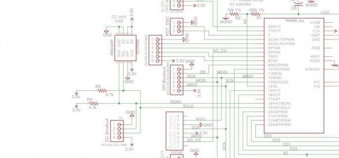

Teensy 3.1 with Adesto RM24P NVRAM connected to SDA/SCL (18/19). Trying to get I2C working, but it's hanging on Wire.endTransmission(). I found several other threads on the same problem, but I did not see a resolution on any of them. Here is a basic I2C scanner sketch that hangs:
Here is the output to Serial:
And that's where it hangs. Both SDA and SCL are low (~0.8V) when it hangs. I haven't put a scope on SDA/SCL yet, but I will tomorrow. It hangs using both the standard Wire library and i2c_t3 library. I confirmed the wiring is correct and have 4K7 external pullups.
Ideas?
