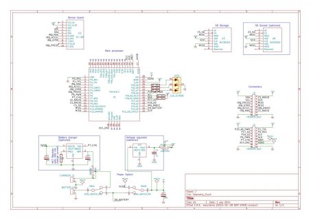

I'm duplicating my other post here, hoping to find a response:
I'm facing sort of the same problem here. Here's my schematic:
I've cut the trace between VUSB and VIN. A physical switch allows to power the Teensy either through a battery (Li-Ion, 3.7V) or through VUSB. Two connectors supply 3.3V to peripherals, either through Teensy's internal 3.3V regulator or via an external MCP1700 voltage regulator. A sensor board and an SD card are always powered from Teensy's 3.3V output. They should NOT need more than the 120 mA that the internal voltage regulator can supply.
I haven't yet traced the exact circumstances under which the Teensy gets hot. I have the impression, though, that it's when it's running on battery with no USB bus connected. The board gets extremely hot, but continues to work.

I have to correct myself. Yes, there was the described software bug that caused a short-circuit, but that wasn't the cause of my overheating.
It still occurs occasionally when the Teensy is running on battery. Never saw it when running on USB, but that may be because the USB port is limited to 500 mA. Once I was able to measure it and the Teensy system drew a whole ampere from the battery. Under normal conditions, the whole system with sensors and radio pulls 130 mA.
As you can see from the schematic above, I have a separate voltage controller for the radio and the Teensy's 3.3 V output is only used for the sensor board (GY-80) and an SD card. No overcurrent here - I think.
WHEN it overheats, it seems to happen even before calling setup(). The K20 reaches about 70-80ºC (measured with an infrared thermometer). I then turn it off and on again and generally it works without any problem.
Given that my system consists mainly of standard modules (Teensy, GY-80, SD card, voltage regulator MCP1702, battery charger MCP73832 and radio module NRF24L01+), I didn't include bypass capacitors for the modules, as all of the have some on board. For the voltage regulator and the battery charger, I used the recommended values. The 220uF capacitor in the VCC line exists to provide me with an additional millisecond or so on a power fail. I use the power fail interrupt to save the current status in EEPROM and recover when the power returns.
Some of the modules are optional, but it seems to me that the problem occurs in all possible configurations.
Here's my question to the more experienced circuit designers: Is it possible that the circuit starts to oscillate due to spikes on the power line and that this causes the observed overheating? If so, what would be the most appropriate measure? Where (physically) should I add more bypass capacitors? Or is a ferrite bead in the power cable more effective?
I'm pretty clueless on this. My ham radio knowledge is a bit rusty and I'm more inclined to the digital world. But somehow this behaviour doesn't seem digital at all...
I built a test bench with another Teensy, a power mosfet and a 0.1 Ohm resistor in series in the power line to measure the current. I switched the system on and off for hours, without a single overheating event.
I thought of a software workaround that measures the Teensy's temperature and resets it in case of high temperature. But if the problem is caused by power oscillations, that wouldn't make any difference.
Really, I'm clueless. Any idea will be highly appreciated...

@jbliesener
Are you connecting the output of the Teensy 3.3V regulator directly to the output of the MCP 1700 output
without any diodes to protect against back currents ?

@mlu
Thanks for your feedback. I admit the schematic's resolution isn't perfect, but there's no connection between the Teensy's 3.3V output and the output of the MCP1700. The external connectors on the right hand side are powered by a signal called "+3.3V", which is provided through a jumper called JUMPER3 or JP2 right next to the (optional) MCP1700. In its default setting (without the MCP1700), JP2 connects it to +3.3VP, which is Teensy's 3.3V output pin.
When you supply the board with the MCP1700, you'll cut that default solder jumper between pins 1 and 2 of JP2 and connect pins 2 and 3, which will supply the +3.3V line through the MCP1700. In that configuration, +3.3VP only supplies the sensor board and the SD storage.
