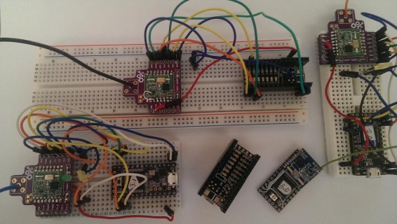

Paul mentioned upside down installation of pins. Here are some I'm working with, a mix of 3.0 and 3.1. These have a SiLabs 4431/4432 data RF transceiver (two different vendors' PCBs). Two have inverted pin/sockets. The inverted pins T3's are: one on the largest breadboard and one place diagonally bottom-center. One non-breadboard 3.0 has the radio piggy-backed, no breadboard. This is experimenting with star and mesh routed networking with $4 radios in 433MHz/GFSK.
