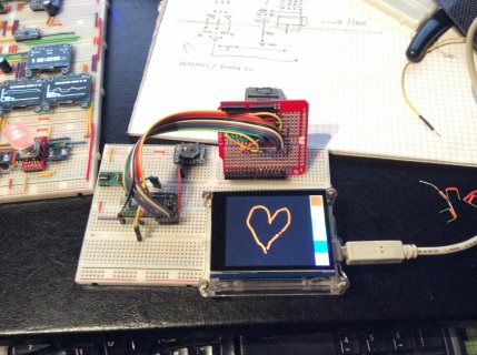

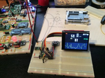

Hiya fellow Teensy Fans
I've been battling with my new Adafruit 2.8" TFT with Capacitance Touch.
I've got it working perfectly with the optimised ILI9341 T3 Library which takes full advantage of the Teensy's super fast SPI. Stunning speed difference so thanks so much for the work put in to that guys! (all my projects rely on non-blocking / max speed for animations etc so essential for me!)
However...
Really can't seem to get the capacitance touch screen side of it working. And what's more, there doesnt seem to be anything at all about this combination of teensy and FT6206working together. I've scoured the net (including YouTube), so here I am, asking for help
Anyone know why the Teensy won't play ball with it? I've got the shield version of this display so I've tested it on my UNO with seamless (but slow) success so the touch & display are all working as normal with the UNO..
Here is the default touch test sketch running on the UNO with some love
And this is showing the screen running on the Teensy (I made up a custom UNO proto-shield matching the UNO pins).
Obviously I'm running my own test sketch on the Teensy above just to get the library etc working for the display side of things (which is running great).. Just touch not happy, but here's the standard touch sketch you get for the capacitance version: (Please note, i'm using the optimised display drivers and sdFat libraries, but this sketch should run, but just can't get past the touch initiation part).
When I run it, I get this back through the Serial:
I'm just using standard pinouts and example straight outta the library so we'll assume everything is as it should be in terms of pinouts / connections and the like..
Also, note the use of the SdFat.h library. Took me ages to get that working, standard adafruit load bitmap also doesnt seem to work but after much experimentation, that library seems to work best for dealing with bitmaps on the teensy etc..
Most probably an i2C issue with this touch screen but not sure where to start. Thanks for any guidance or fixes or hints
Initializing SD card...OK!
Initializing Volume...OK!
Open Root...OK!
Loading image 'andology.bmp'
File size: 230454
Image Offset: 54
Header size: 40
Bit Depth: 24
Image size: 320x240
Loaded in 623 ms
Couldn't start FT6206 touchscreen controller
