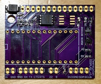

@FrankB My understanding there is a cap not grounded on the board? Are you going to fix or is it trivial to jumper? I need to order from OSH as this is moving forward.
Carter
HI,
yes, there is a GND area some 1/10mm away. Or, maybe, it works without the cap?
The ParallelFlash interface is tested, the lib (compatible to Pauls SerialFlash) is in the works. At the moment, i don't know wether it is faster than serial, or not:)
Display works, touch too, backlight pwm works (use a very low resistor (or an other FET?))
The only thing not tested is the (Parallel-)RAM - i think we don't need it. Maybe! i add it later (...and the software has to be done)
I tried to run the jar file under Ubantu 14.04 but java 8 not supported, it does run under windows 7.
On thing, maybe you should remove the SD-Slot on the display - this depends on how you solder the board - the Serial Pinheader is very near. Or use some kind of isolation.
Edit: The Board is intended for 2.8'' version of the display...

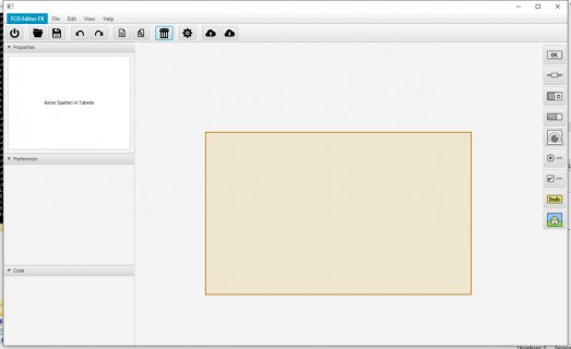

A little description what data we need to transfer to the Teensy (TCD-Editor = Teensy Controlled Display - Editor ...)

A new version of the TCD-Editor is availabe at my Github repository - be aware it's an early alpha version! There are some more steps to walk until some data might be generated and dumped to the Teensy ...
@Frank B: the board arrived today, THX! S0o I only have to wait for the display itself (I gave my last one to my son ...)
The art of soldering...NOT :)
Well, at least all other connections and ParFlash should work. I could'nt test this particular board..
p.s. the 5v in is optional.

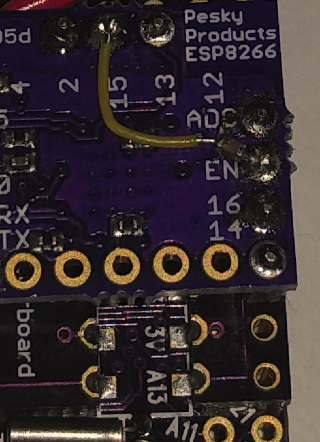

This is what I got and had good luck with: SRA-Low-Temperature-Lead-Solder-Paste
I use very little very infrequently. The needle was easily clogged - so I plugged the needle with wire and just remove/unscrew the needle tip and squeeze out a needed pile on a sheet of paper. Then scoop it onto the desired pad. Seal up the needle tip and dispose of the paper.
I've used it to put SMD caps on onehorse pins (ESP in development), solder one of your CONNECTOR boards, solder a onehorse 9DOF to the under pads, solder RAW ESP-8266's to adapter boards. For practice I put an ATTINY 85 onto an adapter board - but never tested it.SolderPasted.PNG The picture shows some of Franks connector board and one of the SMD Caps and some 30ga Wire wrap wire in place. I used this Connector board to connect to ALT Serial2 pins and it worked of course to talk to the ESP as the early version was wired to Serial3.
<edit> I posted this elsewhere - I used the paste to fix this USB Flash drive that was kicked pulling up and cracking the PCB traces - the paste spread easily and melted fast.

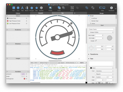

A quick question aside - as the development of the editor is frozen a little because the lack of time on my side, I wonder, if someone might know about the tool "PaintCode" für the Mac (for Swift, Objective C or C#) which also allows to generate GUI elements and export them as drawing routines in code or SVG.
Oh, that looks good!
But how to display the SVG on a teensy ? (Is there a lib we could try to port..?) Or do you convert it to an other format ?
