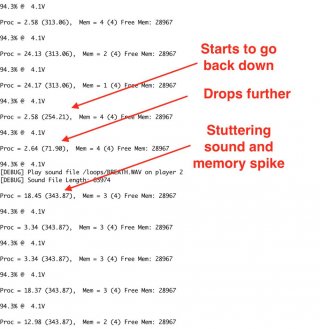

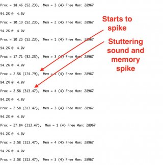

I've been trying to diagnose an issue whereby the Max Processor Usage (see code) suddenly spikes and a loop I have playing from SD will stutter for a second. This cycle continues at a seemingly random interval (spike, stutter, drop to normal, spike, stutter....)
I am playing a 1 minute loop .WAV file and restarting it after it ends. I have tried different SD cards, different WAV files, different AudioMemory values...nothing seems to affect it. I noticed this in a different sketch, so I put together the basic one below to start from a base to diagnose, and it's happening even with this very simple sketch.
The output below is written every 1 second. This spike does not happen often...it could be anywhere from 3 to around 10 minutes between occurrences.
