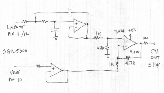

First, use an audio codec or DAC chip, not the built-in DAC. Those chips have oversampling and interpolation filters. They still produce some stepping and ultrasonic output, but it's much less and only at much higher frequencies, which is much easier to remove with an opamp-based analog filter. Pretty much all the high-end DAC chips recommend such a filter. After the filter, you should have a very high quality waveform.
From there, it's a pretty simple matter to use another opamp to increase the signal level.
Would the Teensy audio board be a good start? I THINK in the end, I'm going to be releasing a proper product that would be sold open source with a Teensy socket, and would be focused on hackability. That said, I'm trying to keep the board size small so as only to take up a maximum of 6HP space on the rack, so if the teensy audio board WOULD work very well, I'd just end up throwing a SGTL5000 and associated required bits on my PCB to save space as I wouldn't need a lot of the extras, but it would be ideal for prototyping, and the SGTL5000 is cheap, so it would be nice if it was a good candidate. The only other chip I've worked with that's similar is the Wolfson WM8741GEDS/V, and that was in an entirely different application that wouldn't really give me any head starts here. All of that said, I believe I read somewhere that the SGTL5000 would have issues creating a 0.1Hz style super low frequency output, though I might have imagined that.
Sadly, I'm not familiar with opamp-based analog filters - if you have a link handy, I'd appreciate it. If not, I'll do my own damn googling and probably find the right thing.
At this stage, assuming I'm using a codec chip like the SGTL5000, I'm still looking at a ~0V to ~3.3V output with the pseudo zero crossing at about 1.6V, and I'm not entirely sure the best op-amp circuit to use to convert that to my desired (settled on, regardless of actual correctness) output voltage range. If you, again, have HANDY a link to a good circuit and op-amp for this, I'd appreciate it, otherwise I'll start testing some of the circuits I've found out in the world. I don't have my teensy3.2 + Audio board handy, so I can't put it on my little pocket scope, but looking at the block diagram, I didn't see any inverters or similar. Sadly, I'm just inexperienced in this area, so please forgive my ignorance!

The audio shield would certainly be a good point to start experimenting. Maybe get some opamps in DIP package so you can experiment with the extra circuitry on a solderless breadboard.

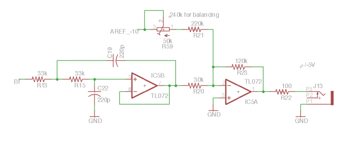

fwiw, basically any LFO is bipolar, meaning the signal swings around 0v. Tides, for instance, will do that (take a look at the output labelled "+/-5V"); it does so because the waveform is 1) inverted and amplified and 2) offset by a constant 5V (or AREF = -10V). and it has a low pass filter which is somewhere around 7kHz.
the snippet from the Yarns schematic you've shown yields -2.5V/10V on the other hand, so that won't work. and the cut-off is somewhere around ~37 kHz, so that's less suitable either.

it seems like I'm going to want to go back to using a high quality DAC (I've got several handy in the 12-16 bit range. I've also got several precision voltage references of varying values.
in that case, i'd definitely give it a try. a downside in using a SPI DAC is the pjrc audio lib doesn't support any, so you couldn't use the library as is. the voltage reference is mainly to isolate things somewhat from the power-rails, as you can't be sure they're very clean.
if your DAC outputs 2.5v, you can basically copy those values. for a -10/10v range, you'd have to, say, lower R20 to 15k. and R21 should be 100k + 20k (or just use 120k, without the rheostat).
i remembered it wrong btw, the cut-off of that filter is 21kHz; for a LFO, you could probably lower it. say use 680p for the caps (which should be of the NP0/C0G type); that'll bring it down to 7kHz.
second downside of that circuit is it won't work very well for pitch CV, but introduce a (very smallish in this case) voltage error owing to the 100R series resistor (R22) (in conjunction with the input resistor of the module downstream). to avoid that, you could move it into the feedback loop. and maybe add a another small cap in parallel to R23 (similar to the Yarns output).
In this case, I note that they only have a 100ohm resistor on output, as seems suitable for audio more than CV applications, but as I might very well want to modulate this into audible range, it seems like not too big of a problem. In the envelopes I've made, I've used a 100k on output, but I understand why you'd want to
100k at the output is way too much! the "rule" is 1k output/100k input impedance, but there's no real rationale to it. that said, it'll be ok for audio and LFOs/envelopes etc. it's problematic when used for pitch (see above)

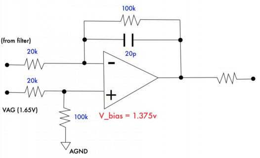

I'm curious if a circuit like this could allow the SGTL5000 to output a reasonable DC coupled +/- 10V control voltage?
Edit: oh, those 4.7K resistors probably need to be 10K, so a 2Vp-p line out can become a 20Vp-p signal.
i don't see why not.
i'd tend towards trying something like this, ie after that LPF (and assuming the line out is 0-2v? and VAG = 1.65v); ... but maybe VAG needs the buffer.
edit. output range is 0.65v-2.65v, so V_bias should be 1.375V:
the 20p is probably not needed. so that's for -5/5v (6* 1.375V - 5*DAC_out)

oh, sorry, i guess we weren't very verbose ... so the idea there i guess is to DC couple the SGTL5000 codec. i never actually used that particular codec, but i suppose all the equalizing and high pass filter stuff can be disabled / set to bypass, so that should be ok.
anyways, i wasn't quite sure i fully understood Paul's suggestion either (the divider after the filter?); my suggestion was the circuit could be simplified a bit by simply using an inverting configuration and biasing the positive terminal. ie you probably could get away without the buffer for the VAG reference voltage so things would reduce to just 2 op amps, or 4 for both channels, if you'd add a/the LPF as Paul's drawing suggests.
basically, what happens in the circuit (the one i've posted) is that the bias voltage produces a constant positive offset (V_bias*(Rf/Rin+1) = 8.25V); and that's summed with the inverted output from the codec:
DAC_out*(- Rf/Rin) + V_bias*(Rf/Rin+1), or DAC_out*(-5) + 1.375V*6
as DAC_out seems to swing from 0.65-2.65V, you'll end up with -3.25V + 8.25V = 5V, and -13.25V + 8.25V = -5V.
