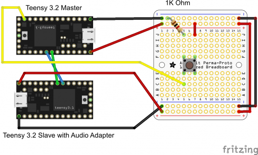

I'm using a Teensy 3.2 w/ Audio Adapter as a slave to another Teensy 3.2. (The Teensy w/ audio board works on its own perfectly.) This is part of a much larger project but I've stripped the rest of it down to just the following.
I want to press the button on the Master and Wire.write(1) and have the Slave receive it and start playing a file. I tested the send/receive code and it works. When I add the audio initialization in the Setup() function, the Slave locks up. I narrowed it down to the "sgtl5000_1.enable();" line.
Is there a problem with using 2 Teeny's like this with an audio board? I'm using arbitrary addresses of 5 and 8. I couldn't find anywhere where it matters what the addresses are. I tried other addresses with the same results.
Any help would be appreciated.
