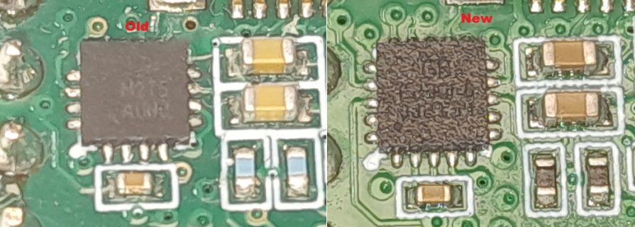

I have been using two different versions of T3.2 for a while. I have recently noticed occasional sticking in bootloader mode when booting up. This only occurs on T3.2 models with the MKL02 bootloader chip. There is no issue with those using the Mini54 bootloader chip.

Quick correction to my earlier post:
I previously said that the Teensy 3.2 boards without bootloader issues were using the Mini54 chip — but that was incorrect.
After closer inspection, the boards that are working fine actually use the MKL02Z32VFG4 (16QFN).
The ones that occasionally get stuck in bootloader mode are using a different chip — specifically a GD32E230F8 in a 20-pin LGA package, not the Mini54.
So just to clarify:
MKL02Z32VFG4 (16QFN) – no issues, works reliably
GD32E230F8 (LGA20) – sometimes boots into bootloader unexpectedly
Apologies for the confusion, and thanks for the help earlier. I had already tried a 10K pull-up on the Program pin, but I’m now going to test with 100Ω as suggested.

Yes, you can leave pin 21 unconnected. You should be able to reproduce the problem with the code in msg #6. The issue might happen either after some minutes, an hour or even several hours. It is not consistent, but it will happen with GD32E230F8 bootloader chip, and never happen with MKL02Z32VFG4.
Just to confirm, I am investigating this problem. But it is not easy because this program uses both low power modes and soft reset. This is the hardware currently on my workbench to attempt capturing info about why it is unintentionally entering bootloader mode.
I believe I've found the problem. It is a bug in the way the new chip handles sleep mode. It escaped notice in previous testing because the bug doesn't manifest unless sleep modes are also combined with soft reboot.
I'm testing a fix now. Will contact you by email soon, as I'm not ready to release a bootloader change to the entire world where so many Teensy 3.2 boards exist, and where the very last Teensy 3.2 boards are now being shipped.
If anyone else later finds this thread and has strange sleep mode problems with these last Teensy 3.2 boards made with the GD32 chip, please contact me.
