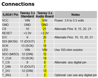

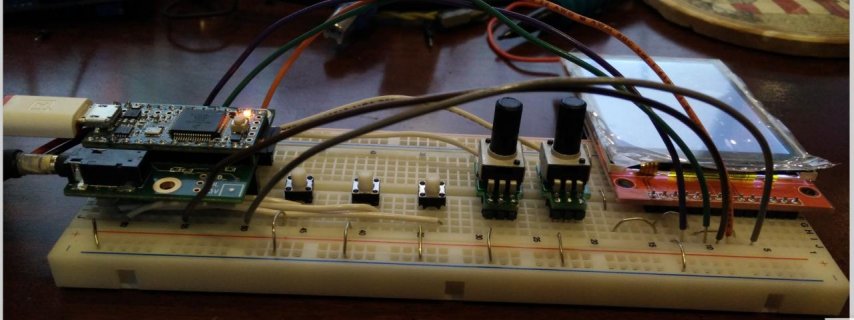

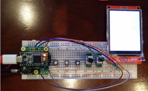

Hi, using a new Teensy 3.2 and with a new Audio Board and the 2.8 Inch TFT Touchscreen sold here on PJRC Store. I'm having problems getting the SD card to work at the same time as the display... they both work separately (so screen is good and SD card good by my reckoning). I am wired up as documented here (using Teensy 3.x Audio Board column): http://www.pjrc.com/store/display_ili9341_touch.html
I've re-wired several times and don't see any hookup errors. I've tried various source code examples including the sample code in the Audio Tutorial: https://github.com/PaulStoffregen/Audio/tree/master/examples/Tutorial/Part_3_03_TFT_Display
Using the following defines (which corresponds to wiring) :

I can post more code but it's really just the samples on github. There seems to be an issue with the SD card reading when I have T_DO (from Touch screen) connected to Pin 12 on Teensy... if i disconnect it, the SD card works. I'm thinking there is a conflict somewhere.
Does anyone have the TFT Touchscreen working with the audio card? I've tried two different teensy 3.2 and both the 2.8 and 2.4 TFT with exact same results.
I'm not positive if the issue is on hardware end or software. Any help would be greatly appreciated!
