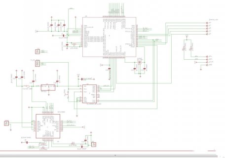

We designed a custom PCB based on the teensy 3.1 and the Teensy audio board. The audio board was needed because Teensy audio library does not allow a second audio input. When this is done, it would make a lot of difference in the use of teensy for audio small audio devices. It would definitely make a difference to us.
My enquiry is:
(a)Can you make the teensy 3.2 part list available on the Teensy site. maybe as a kit...
(b) Not sure if this is already available, is it possible to provide the Teensy 3.1 and 3.2 Eagle files. This helps avoid potential errors in the design of custom PCB., especially on BOM and footprints.

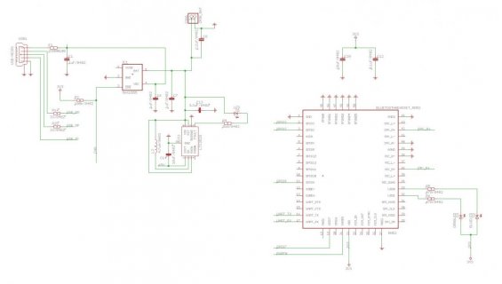

There was an issue that arose because the Teensy 3.1 schematic had the 16MHz crystal without capacitors. However, my designer added the capacitors because a crystal guideline advised to use capacitors. This lead to some confusion with the PCB house and sorting out the BOM.
Hence why it would be great to get a clearer instruction on using the teensy 3.1 and 3.2 for custom design. 27-09-2015 15-51-13.jpg27-09-2015 15-54-56.jpg
(c) If it possible to add the second audio input to the Audio library without the teensy audio board?
