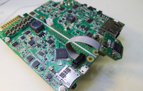

I hope I'll soon find time to start document the project. It's a Teensy 3.1 custom build + MCU controlled MPPT solar charger + weather station (wind speed, direction, rain, temp, humidity) + USB host with G3 modem stick and software PPP TCP/IP stack + simple audio amp/headphone + SD card + (the most important thing) gamma spectrometer with low power high voltage generator. It's my first design in electronics. Second PCB revision. And it's mostly working ;-) Third revision is in progress and I'd hate to introduce new problems...

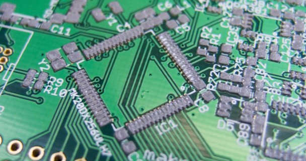

As I said I pressed down quite hard but it still looks way too thick:

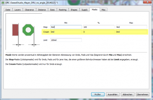

Perhaps it would help to reduce the cream layer outlines in relation to the smd copper in Eagle?
Any suggestions welcome.
Thank you very much!

Markk: That thickness looks good to me.
If its only the processor that's bridging, I would look at the chip part library and make the creams smaller. Or reduce them globally as you're showing.
The problem with thinner stencils could be warping etc.
Normally the stencil house does a size reduction on the pads for small pads as the paste should be smaller than the pads, then a tombstone reduction where bigger SMT pads have a trapezoidal shape to pull the solder away from the center of the part to give good fillets and then on large pads like a voltage regulator or thermal pads a technique called a window pane is used to allow the flux gasses to escape.
