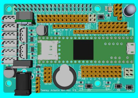

Not sure if anyone would find it useful, I also have some part layouts for Diptrace. Although I also use some of the other Eagle ones where I then convert to diptrace...
Also in addition, in Diptrace, there is the ability to do 3D previews of your design. For this I used Fusion 360 to create me a part to represent the T3.6(or 5). Which I have as a step file. Which you can see in the following rendition:
