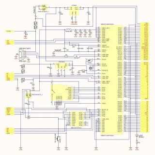

I had missed a couple of components in the schematics, sorry about that...
Anyways, thanks to all of you guys I finished the Eagle schematics. Hopefully it'll be a boost start for others in their quest for custom Teensy.
I changed the fuse to the one which HWGuy suggested: Bourns MF-FSMF050X.
As advised here, I picked ECS-160-8-30B-CKM for the 16 MHz oscillator. For others who come across, consult here and here for careful layout design of your oscillator.
Finally, for the 32.768 kHz crystal I picked ECS-.327-CDX-1128.
If you find any faults, please let me know so I'll update this post.
Update (May 6th, 2017): Fixed some disconnected joints on the right side of micro controller. Also, TPDS014 and LP38691 are replaced with their fixed versions.

Hello again everyone,
As my project progressed, it seemed proper to switch for Altium. So I redrew the schematics.

ICs were easy to make as Altium had a wizard for this purpose. 3D model for the microSD slot was downloaded from this GitHub repository, and other components (resistors, capacitors, ferrites, pads and micro USB port) were from here.
Hope you enjoy, and let me know if you find any flaws ;)
Update (May 30th, 2017): Fixed the missing A4 pin on the micro controller.
