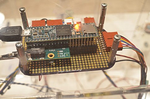

Hey guys,
I've got a teensy 3.5 and a Audio Adaptor Board.
I was checking and it doesn't look that I can stack them like with the older version of the board.
Where can I get the info on how to connect them properly. I will be powering the circuit from an usb cable.
Thank you :D

You should be able to stack them. I haven't used the audio board in awhile, but the first 14 pins on each side of the Teensy 3.2 and Teensy 3.5/3.6 are pretty much the same, and since the audio board doesn't use the back 5 pins, you don't have to run wires to connect the DAC pin to the audio board.
In particular, the Audio Shield uses the following pins:
  • Pin 6: Chip select for SPI memory board on the audio board
  • Pin 7: SPI alternate MOSI pin
  • Pin 9: I2S BCLK pin
  • Pin 10: Chip select for SD card reader on the audio board
  • Pin 11: I2S MCLK pin
  • Pin 12: SPI MISO pin
  • Pin 13: I2S RX pin
  • Pin 14/A0: SPI alternate SCLK pin
  • Pin 15/A1: Potentiometer on the audio board
  • Pin 18/A4: I2C SDA pin
  • Pin 19/A5: I2C SCL pin
  • Pin 22/A8: I2S TX pin
  • Pin 23/A9: I2S LRCLK pin
Get these 36 pin female stacking headers from Adafruit:
And using diagonal wire cutters, cut them down to 24 pins. Solder one set of 24 pins on each side of the Teensy 3.5/3.6. Either solder those pins to a permanent prototype board such as:
Or just mount the Teensy in a breadboard.
Then take normal male breakaway pins and solder them with the long end down on the audio board:
Mount the audio board on top of the Teensy 3.5/3.6.
Power the board as normal with USB.
Here's a project I've been building for Bay Area Maker Faire.
Hopefully this quick photo gives you an idea of how it can be done. This isn't the only way, but I can tell you we got the whole thing up and running last night, so the hardware you see in this photo is definitely working.
