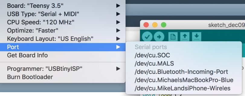

Teensy 3.5 no port
I've been over and over and over with this... Teensy 3.5 will work for a while, and then it won't recognize a USB/Serial port to program anything (inside the Arduino IDE). It just randomly works, and then it doesn't. It's getting power and all, and it still works with the sketch I had previously installed (It connects to a BLE break-out/iOS app I'm developing, everything soldered to a PCB... But even before the PCB when I had the Teensy on a breadboard I had the same issues), I can't program anything (blink, etc) without a port.
I have tried deleting all Arduino & Teensyduino files and re-installing. Nothing seems to work. I've tried various versions of the Arduino IDE also. I'm on OSX 10.13.6
This is probably the 5th time this has happened...It just seems to "fix itself" every once and a while and then stops working again. Any help would be appreciated.

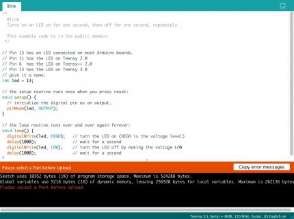

Does it work to upload with push of Program button?
With TeensyLoader open the Help / Verbose info to see what it shows for devices.
No idea other than BLE device usage or code provided, perhaps it is faulting the processor for failed memory access or other coding/hardware problem? Perhaps this will show if that is the case: debug_t3 library zip is posted there - not a real thread yet - but posts in that thread should show its use.
The program button does nothing...The BLE isn't the problem, It's always worked with the Teensy & still does. But I can't get the Teensy to find a port to program a new sketch.

Not showing up at all in the "Teensy Ports" menu is usually caused by a bad USB cable or other USB hardware issue.

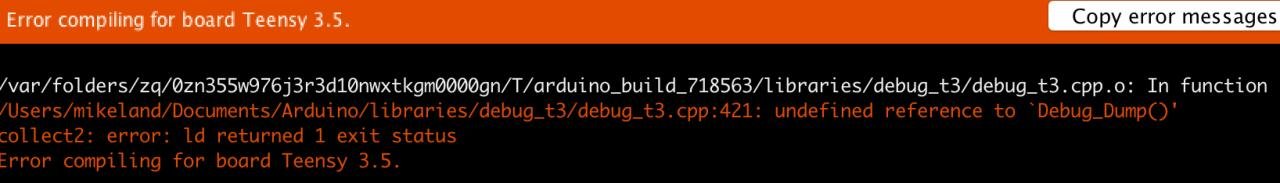

The error in msg #6 is a programming mistake (unrelated to USB, hardware, port detection), maybe something wrong in that library?
No button push during the verbose mode output. I get an error with the debug_t3 #include View attachment 15328
My bad it seems on the zip file not including the code below for missing file:: ...libraries\debug_t3\debugdump.cpp
A quicker fix would be to put this in your sketch:
I've tried multiple USB cables, all of which work with all of my other arduino boards (UNO, mega, Teensy 3.2, and a Mini-Rambo I use to run an MPCNC machine). I get a serial port with all of those boards, never had a problem with the cables before
You keep saying "serial port", so I want to be clear that Teensy sometimes uses serial or other protocols, other times uses HID protocol. We get this misunderstanding pretty often from people who are very used to Arduino's model of "everything is a serial port".
Not everything is serial. Most of Arduino's boards have a dedicated USB-serial chip, so they are always the same serial port. Knowledge & experience with that sort of hardware does not always apply to native USB boards, where the USB changes.
Teensy uses HID, not serial, when in programming mode. This is important to understand for troubleshooting.

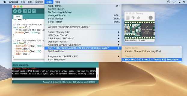

Here's a screenshot from my Macbook Air, to show you the best way to troubleshoot.
There are two important points in this screenshot.
#1 - Turn off the "Auto" mode in Teensy Loader. By default Arduino turns it on, so Teensy will reprogram and reboot with your freshly compiled code as quickly as possible. For troubleshooting, you want to turn Auto mode off, so you can see whether Teensy Loader detects the hardware.
#2 - In the Ports menu, Teensy appears as "HID=16c0:0478" when it's in programming mode. It is *NOT* a serial device. This is normal, because Teensy uses HID protocol in this mode. If your Teensy and Mac and USB cable are working properly, you should always be able to get Teensy into this mode by pressing the button. Normally when Auto is turned on, this mode lasts for only a second or two. With Auto turned off, you can easily observe whether Teensy is working properly and your Mac is able to detect it.
In all other modes, the USB communication on Teensy depends on the code you've loaded into its memory. This is different from boards like Arduino Uno which have a dedicated USB chip. On those boards, no matter what your program does, you can't mess up the separate USB-serial chip. On Teensy, the USB is running in the same chip and is controlled by the code you've loaded. That's why you can do stuff like the Tools > USB Type menu, which is obviously impossible on boards like Uno which only work as serial. But it also means plenty can go wrong, because the USB is on the same chip as your program.
So please, for the sake of troubleshooting, turn off Auto mode and press the button, then look for the HID interface (not serial). This mode runs only the bootloader from PJRC and does not depend on any code you've put onto Teensy's memory. Troubleshoot first with this mode, so you're running with a known-good setup code-wise, while trying to figure out if something is wrong with the hardware or on your Mac.

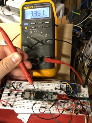

On my PCBs that use Teensy I always include the option for a USB-B Male port, and jump to it by soldering wires to the pads on the bottom of the Teensy (see the Eagle CAD portion of my screenshot). I do this because I have several clients that hate those micro-USB ports (I guess they're clumsy and have broken them in the past when plugging/un-plugging the cable). In this case, the larger USB-B port wasn't needed, so I didn't bother jumping the D- D+ pads before I soldered the Teensy to the PCB.
However, I just tried soldering on the USB-B port anyway, and jumped some wires from the D- D+ through-holes on the top of the board since I no longer have access to the bottom. Tried several USB cables with that as well, no HID port.
The teensy is definitely getting power & ground, as it is powering the adafruit BLE on the PCB and my iOS app can communicate with it. Something's going on with the USB data in/out here? Like I mentioned before, I've been having this problem with this board even when it was just on my breadboard.

Have you checked the Teensy output voltages - there are 'Troubleshooting' posts somewhere about that given it may be physically/electrically unhealthy?
The first would be seeing 3.3V on those pins when proper VIN is applied - it seems there is at least one more check perhaps involving PGM or RESET.
No backup Teensy to test with?
The 3.3v output next to the analog ground is functioning, but have only probed reset and program pins to check state change during a button press(both go low as expected).
I’m wondering if there may be a cold solder joint somwwhere that experienced thermal stress during the cold to warm cycle of working outside and then bringing inside. I’ll lightly push on some components while testing...I was running out of ideas at 2am. 😅

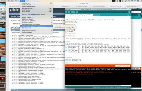

When I click program in Arduino IDE, I see the verbose output in Teesnyduino:
14:42:51.101 (loader): file changed
14:42:51.113 (loader): File "Teensy_PWM_white_LED_RTC_V1_FUNCTIONAL.ino.hex". 41828 bytes, 8% used
14:42:51.239 (post_compile 29): Begin, version=1.45
14:42:51.240 (loader): remote connection 13 opened
14:42:51.245 (post_compile 29): Sending command: comment: Teensyduino 1.45 - MACOSX (teensy_post_compile)
14:42:51.251 (loader): remote cmd from 13: "comment: Teensyduino 1.45 - MACOSX (teensy_post_compile)"
14:42:51.254 (loader): remote cmd from 13: "status"
14:42:51.257 (post_compile 29): Status: 1, 1, 0, 0, 0, 0, /var/folders/5m/_mwb08456bn5nr_w8c8gv2100000gn/T/arduino_build_230920/, Teensy_PWM_white_LED_RTC_V1_FUNCTIONAL.ino.hex
14:42:51.257 (post_compile 29): Disconnect
14:42:51.289 (post_compile 30): Begin, version=1.45
14:42:51.340 (loader): remote connection 14 opened
14:42:51.343 (post_compile 30): Sending command: comment: Teensyduino 1.45 - MACOSX (teensy_post_compile)
14:42:51.350 (loader): remote connection 13 closed
14:42:51.358 (loader): remote cmd from 14: "comment: Teensyduino 1.45 - MACOSX (teensy_post_compile)"
14:42:51.369 (loader): remote cmd from 14: "status"
14:42:51.372 (post_compile 30): Status: 1, 1, 0, 0, 0, 0, /var/folders/5m/_mwb08456bn5nr_w8c8gv2100000gn/T/arduino_build_230920/, Teensy_PWM_white_LED_RTC_V1_FUNCTIONAL.ino.hex
14:42:51.372 (post_compile 30): Disconnect
14:42:51.384 (post_compile 31): Running teensy_reboot: /Applications/Arduino.app/Contents/Java/hardware/teensy/../tools/teensy_reboot
14:42:51.452 (loader): remote connection 13 opened
14:42:51.458 (reboot 32): Begin, version=1.45
14:42:51.458 (reboot 32): location = /dev/cu.Bluetooth-Incoming-Port
14:42:51.458 (reboot 32): portprotocol = serial
14:42:51.458 (reboot 32): portlabel = /dev/cu.Bluetooth-Incoming-Port
14:42:51.458 (reboot 32): Serial device /dev/cu.Bluetooth-Incoming-Port will be tried first
14:42:51.458 (reboot 32): USB device add callback
14:42:51.509 (loader): remote connection 13 closed
14:42:51.519 (loader): remote connection 13 opened
14:42:51.521 (reboot 32): USB device remove callback
14:42:51.522 (reboot 32): Serial add callback
14:42:51.532 (reboot 32): Serial remove callback
14:42:51.535 (reboot 32): HID Manager started
14:42:51.536 (reboot 32): Disconnect
14:42:51.611 (loader): remote connection 13 closed
14:42:51.628 (loader): remote connection 14 closed
