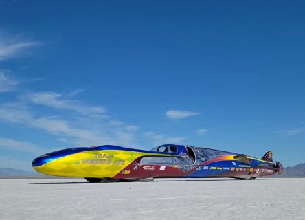

As an offshoot of the work I've done with the Speeduino ECU, I've been working the last few months to adapt the project into a FADEC turbine controller rather than piston engine controller. This is for use in a turbine powered streamliner, Turbinator II, that is currently the fastest wheel driven vehicle with a 2 way average speed of 458MPH.
It's been a bit of a mad scramble to get the hardware designed and tested, but the team is now at the point of being ready to run things in the car and will be heading to Bonnevile over the next week in the hope of breaking the 500MPH mark (Which it has done previously, but not with a return run).

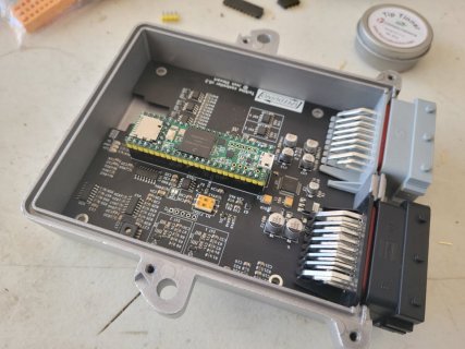

Bare units straight from PCBA
Board with connectors and Teensy mounted in enclosure

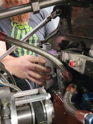

Unit being mounted in the car
The hardware is pretty rough, but between crazy long manufacturing times due to IC shortages and a somewhat moving target in terms of requirements, I'm pretty happy with the outcome so far and everything appears to be functioning as expected. There's certainly a few quality of life things that can be added for future revisions, but this will do everything needed for this run.

Unfortunately due to a number of issues on the car it wasn't able to make our test pass until the third and final day of World Finals at Bonneville. There wasn't time to make a full 5 mile pass as as there was too much that needed shakedown testing on the shorter 3 mile run first.But that run was very successful!
The car was able to run the fastest 1st, 2nd and 3rd mile speeds in the history of Bonneville Land Speed Racing, which dates back to the 1920s.

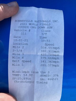

Some of the major data points:
Peak GPS speed 447.9mph
3 mile average of 420mph
Fuel consumption peaked at 2100 pounds per hour, resulting in a shaft horsepower of 4185.
All with an engine controlled by a Teensy 3.5 :D

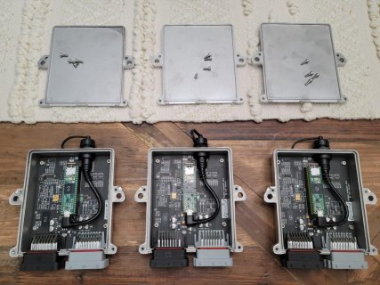

Thought I'd give a bit of a heads up for anyone interested. This car will be at Bonneville Speedweek from August 6th and again aiming for a new world record (C'mon 500mph!) in its class (Fastest wheel drive car). Will be running the same hardware as last year, that is a Teensy 3.5 powered FADEC controlling the 4000+hp jet engine, but with some significant changes on the firmware front. 3 units are set up and identically configured to allow for hot swap if needed, with parts available for another 2 if everything somehow goes to crap.

Hardware is based on the Speeduino ECUs I've done, with these using the same circuit designs for power regulation, RPM inputs, CAN, analog inputs and general purpose inputs/outputs. The fuel outputs are quite different though and there is the addition of a pair of MAX31855 based EGT inputs. The analog inputs use the onboard ADC with the signals (A mix of 5v transducers and resistive) being filtered, run through an OpAmp and then clamped. They also run off their own precision referenced regulator rather than the main one.
The main control loop runs at about 19Khz with the SD logging on, which is plenty fast enough for what's needed here. It's basically looking up a main 16x16 fuel table with a few other tables used for compensation of various elements. Compared to an automotive ECU it's quite simple, but it does also have a whole heap of engine safety checking, particularly during the (6 stage) startup sequence, to avoid any damage to the turbine. Even brief over temp and over speed events can be catastrophic (aka $$$$$$ expensive) so need to be avoided under all circumstances.
