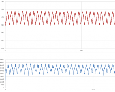

Issue: Teensy 3.6 ADC is returning incorrect values with 3.3v reference and impossible values with internal 1.2v reference (returned values greater than 16 bit). I have built a BLDC motor controller that utilizes a MAX40201FAUA amplifier IC (50V/V) to read the current across a 0.001ohm current sense resistor. The chip and resistor were sized to return the full 3.3v ADC range for a current through the resistor of up to 50 Amperes. For this issue, I was putting no more than 1.3 Amperes, verified by NI ADC, across the resistor, meaning that the voltage that the Teensy 3.6 sees should be no more than 0.0625v for this amperage. Yet the Teensy 3.6 is telling me that the MAX40201FAUA is reporting a voltage of around 1.8 volts for a 1.25A current, which should be impossible. With the Teensy ADC reference changed to 1.2v internal, the Teensy ADC reports values well in excess of 16 bit (100,000+), which as far as I know should not happen.
Even stranger, the waveform that the Teensy reports LOOKS correct when compared to the waveform that the NI ADC is seeing at the power supply, just that the magnitude is way off! Graphs of these effects are shown at the very bottom of this post.

About the software: To synchronize the ADC capture with the PWM motor drive phases, the PWM FTM clock activates a PDB timer at the start of each PWM cycle that delays for a period of time (<PWM modulus), then triggers the ADC to read. This makes it so that the ADC is reading ONLY when current is flowing through the BLDC motor.
The top plot is the TOTAL current consumption for the driver (Teensy, motor and all other components). The motor drive consumes all but about 30MA of this power. It was captured via a NI ADC Card connected to a 1 ohm power resistor for current measurement. This is RMS current. I can post the raw current plot, but it is very similar with no major spikes that would imply the teensy is seeing surges of any kind.
The bottom plot is the data recorded by the Teensy 3.6 connected to a MAX40201FAUA+ 50V/V amplifier IC and 0.001 current sense resistor. What is measured here should be identical to the top plot once converted, but the ADC output values make NO sense for a current of ~1 Ampere. This data was processed through a FIR filter with alpha = 0.1 to remove some of the high frequency noise.
