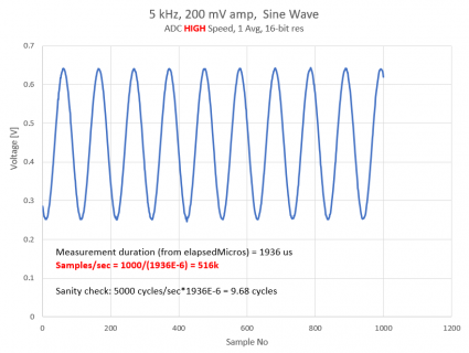

I am testing out the ADC functionality of my new Teensy 3.6 and have encountered an issue I do not understand. I setup a simple test using the signal generator on my oscilloscope to output a 5 kHz sine wave into pin 17 on the Teensy. The ground connection on the signal generator was made to the Analog Ground pin. Here is the code I used:

And here is the output I got for different ADC speeds:
I am thoroughly confused by this data. It seems clear that the program is collecting 1000 samples within 487 us for each speed. That gives a sampling speed of roughly 2 Msps! How is this possible? I feel like I am missing something simple. I hope someone can help me out.

That worked! Thanks. I'd still like to understand what was happening with my initial code though. It appears that the program was filling up the buffer with 1000 samples as fast as possible, regardless of the state of the ADC. But, if that is the case, why did I get a sine wave at all? It seems like I should have gotten mostly the same values over and over.
You did. That's why the LOW and MED speed output has a "staircase" instead of a smooth sine wave. You didn't wait for the conversion to finish so the function returns the same value as last time until there is a new value.
