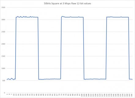

I ran a test with a square wave. Interesting noise. It is max about every 256 points, probably when I write a sector. No surprise, no signal averaging short S/H. No 50 ohm load, dangling wires, USB power, ...
Data is attached. No ideal 12-bit 74 dB SNR here.
A closer view.
  • squareData.txt
