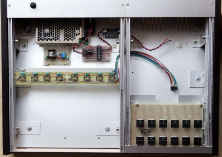

Using a Teensy 3.6 to control 8 ALPS motorfaders:
L293B H-bridges are used to drive the motors. The fader wipers and touchtracks are connected directly to the Teensy. Each faders has it's own PID control using 12 bit PWM at 14648.437 Hz. The ResponsiveAnalogRead library is used for the analog inputs, notice how stable the values are. Separate timers are used for the analogRead and touchRead:
elapsedMicros sinceFaderRead;                         // timer for fader check
unsigned int  faderReadInterval=500;                  // interval in microseconds for checking fader position(update)
elapsedMicros sinceTouchRead;                         // timer for touch read
unsigned int  touchReadInterval=5000;                 // interval in microseconds for reading fader touch
A second Teensy is reading the values from the faders via I2C and shows the raw values on the LED displays using the LedDisplay library.
Fader panel bottom view:
The plan is to create a MIDI step & pattern sequencer with presets and this is an important first step. The code will of course be available when finished, in the meantime I'll be happy to provide snippets if somebody is interested.

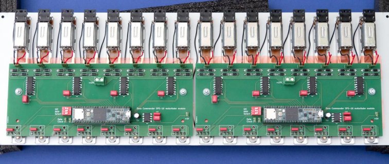

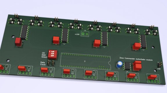

While strip board is nice to develop and test stuff there comes a point when you just have to create proper circuit boards for your project so I took the time to learn how to use KiCad and designed boards for my sequencer project. I’m not an electrical engineer but I tried to design the board as best as I could keeping the high current motor stuff as far away as possible from the fader input. The thermal relief for the four ground pins of the L293B was removed as the copper ground plane is used as a heatsink, same for the high current connections. The copper layers are 35µm.
This is what the KiCad 3D render looks like:
And here’s a picture of two boards for a total of 16 motor faders:
Here’s the KiCad project: View attachment Fader_Motor_KiCad.zip
The updated sketch for the panel: View attachment Zeus_FaderPanel_181227.zip
Any comments on the board design are welcome. There's at least one issue that needs fixing; the 100µf capacitor on the analog reference should be moved, the USB connector barely fits. Note that he pin numbers in the schematic do not match as I had to move around pin connections to fit everything on the PCB, the sketch contains the correct numbers.
The new setup has completely separate power supplies for the 5V logic and the 10V motor supply and the faders all have 10nF decoupling caps directly on the input, the result is that the response of the faders is most excellent. The link mode is working flawlessly now, completely stable values while 15 faders follow the one that’s moved. It's really nice to see how 15 faders move like a perfect Roman cohort as they follow the fader that's moved.

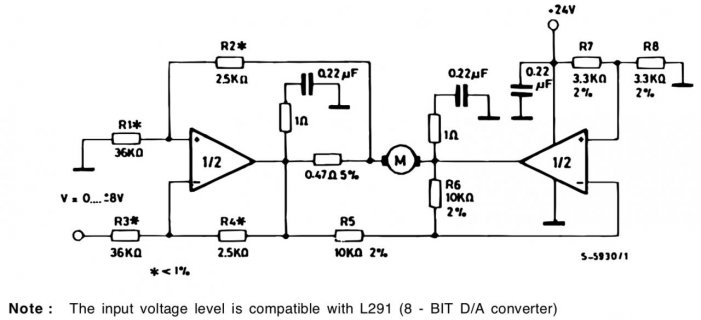

The only thing that could be better about Gerrit’s design is not using PWM to control the fader motors. To offer a solution to that I’m going to be working on drawing up a schematic from this board:
This controls the fader position basically without even a microcontroller, the microcontroller is used to set the voltage on a DAC and based on that voltage the fader is moved until the wiper voltage matches without taking up processing time for PWM. On top of this it doesn’t require the use of any touch pins so no extra processing time is stuck on that either, it takes a little bit of circuitry to accomplish this but I’ve found it more stable than touchread ever was. This also means that the circuit requires no calibration for PID or touch threshold so it’s always accurate with no fader jitter from PWM.

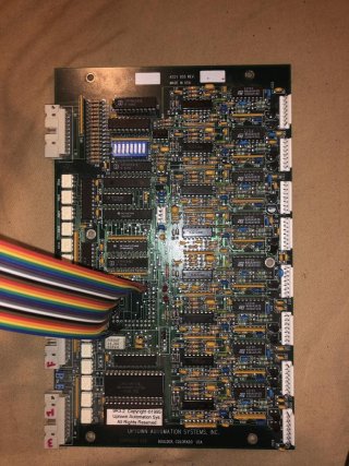

The circuit is originally from an Uptown System 990 that came with our console built in the early 90's, it's pretty old technology, but nothing compares to the smoothness that was achieved with it. They used 8051 microcontrollers and an old DOS pc to control it, so you can imagine how much of a performance boost a Teensy 4.0 is considering it's faster than the pc cpu that used to run it. It's a great circuit, but I want to downsize it and increase the resolution of the motor control since the DAC is only 8 bits because the 8051 was 8 bit. So in the next coming days/1-2 weeks I'm going to be reverse engineering the schematic from this board so I can accomplish that and get rid of the unnecessary parts that I no longer need from the 8051.
First video is when I was testing it with no micro controller hooked up by using the set of dip switches on board to select the DAC voltage and the motors are being power by 12 volts here. You can hear how quiet the motor is here with a known good fader.
Second video I had it hooked up to a Teensy 4.0 and w5500 for Ethernet to test it with Pro Tools Diginet doing simple sawtooth automation and the motors are at the full 24 volts here. Here some of the motors sound really loud because the faders are in dire need of a tune up.
I didn't take any other videos when I had it all connected, but this at least gives you an idea of how it performs. This project is also why I'm working on USB Ethernet in my other thread because the w5500 doesn't give me the performance that I need it to for the Eucon protocol, but it was enough for the Diginet protocol to get the basic test performed with it.

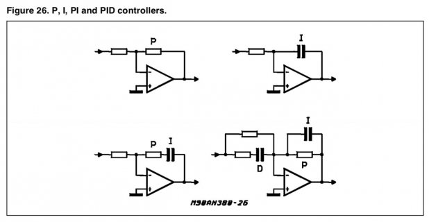

It could be the H Bridges or your power supply isn’t suppling enough power to the motors.
As far as for audible noise your only option is to increase the PWM frequency or ditch PWM entirely. Upon reverse engineering the Uptown 990 circuit I found out they used the schematic straight from the data sheet just with a couple different resistor values. They used an L2720 power op amp in a DIP package, but that is no longer being sold. The replacement is an L2720W SOIC package which doesn’t deliver the same amount of current per channel, but should still deliver enough for faders.
They also use an analog PID circuit so it has no effect on the processor, I’ve found this in an application note which matches the same circuit.
The last part of the circuit is effectively an instrumentation amplifier that handles setting the fader position for the processor which frees up cycles.
I finally ordered the parts so I’ll post a final schematic once I have all the values tuned to how I want it. My faders do not work with PWM since they have a variable torque requirement because of the position of the motors which just can’t be compensated for while using an H Bridge.

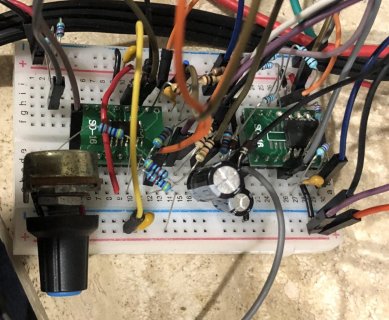

Alright I finally got one channel breadboarded and tuned the PID with what I had available on hand and it’s pretty good (quick and accurate). It’s quite a bit of components per channel, but I personally feel it’s smoother than PWM.
Here’s what the breadboard looks like:
Quick video of it action, there is no motor noise just noise from the bushings being worn out in this fader:
It can still be a tiny bit faster, I only have a 20v power supply on my test bench, this is also without having the correct op amp since this one can't produce close to its rails so moving the fader up is ever so slightly slower than going down right now. To interface this analog circuitry with a Teensy you would have to use a DAC in place of the rotary pot which I plan on using 2 AD5592R DAC/ADCs per 8 channels for a theoretical 12 bit resolution. This uses very little pins so if you wanted to you can control a lot of faders and other peripherals with just one Teensy.
I'll make a schematic of this likely tomorrow, this breadboard doesn't currently have the circuits for the low pass filters and buffers connected that would be on this in a final product.
