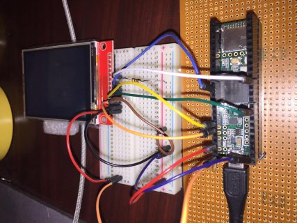

I have not been able to get any of my ILI9341 spi displays to work with the Teensy 3.6. All I get are white or grey screens with occasional flicker as the graphic test proceeds. (I have tried three different displays, one of which is the PJRC 2.8 touch screen.) Each of these displays works when driven by an arduino or esp8266. I am running Arduino 1.8.0 with Teensy Loader 1.34 on a Macintosh.
Attached is my code which is an slight modification of the ILI9341_t3 graphictest example... Note that I am using the pins suggested for use with the audio board (per the PJRC page for the Color 320x240 TFT Touchscreen, ILI9341). I have tried the normal teensy 3.x spi connections as well with the same result. I am pretty sure my connections are correct. A photo of my connections is also attached.
Your assistance is appreciated.

Also here are the results of the tft diagnostics from the graphicstest sketch. Some how I expect all the 0xFF's to be errors?
ILI9341 Test!
Display Power Mode: 0xFF
MADCTL Mode: 0xFF
Pixel Format: 0xFF
Image Format: 0xFF
Self Diagnostic: 0xFF

Hi All,
I am still struggling to get my spi ILI9341 display to work with my Teensy 3.6. I put my old oscilloscope on each of the display pins. As best as I can see, the signals are ranging from just above 0V to just below 3.3V. Adding pull-up and pull-down resistors did little to change the signals. I have read a few posts in the forum that suggest slowing down the cpu to see if the display works. Not sure how to do that. In the long run slowing the cpu down is counter to the reason for purchasing a faster cpu.

I would double check your wiring. Also I assume your headers are soldered to the Teensy? I would double check your soldering.
Sometimes I have had displays that did not work without reset pin connected up. So try connecting to IO pin and change the number in the define.
I have that display working with a few different T3.6 boards, so it should work.
But it is hard to see for sure in the picture where all of the wires are that plug into display. Example between: CS Reset DC pins hard to be sure they are all plugged in correctly.
If you have an old scope, does it have two channels? If so if you connect to MOSI and SCK, does it look like SCK is doing a good regular clock like pulse andthe MOSI pin showing some some different values depending on what data is being sent?
Sorry don't have anything specific...
I also have several of these displays working with several Teensy 3.6 boards.
Your code seems typical but your picture of the connections is a bit hard to trace.
I would start by double checking your connections against the "connections" table found at
https://www.pjrc.com/store/display_ili9341_touch.html
One connection that is different from the table and is different from my working displays is that you appear to feed the backlight LED Resistor (100ohm) from the Teensy 3.3v supply rather than the more common VIN (5v) pin. I would be surprised to find this would make a big difference but it is a 'difference' between the usual 'working' examples and your 'troublesome' display.

So again I wonder about wiring. Again things like are the headers soldered onto the teensy? There have been a couple of cases lately where someone thought that the friction between the headers and the Teensy would work...
Sometimes if I wonder if the IO pins are working, I remove all of the wires running to things like the display. I run a simple sketch like:

Thanks for the code, all of my pins (21, 20, 7, 14, 12 and 10, 9, 11, 13, 12) are working. The LED was flashing nice and bright. I did reheat all of my solder joints, they all look good. Wiring still looks correct.
One thing that I have been doing all along is supplying 5V regulated via an external supply (LM7805) at VIN and GND (near pin 0). I do have the external supply isolated from the USB supply as I have cut the trace on the backside of the board. I have recently added a 10uF and a 0.1uF capacitor at the output of my LM7805 supply. This seems to have improved things just a bit as it has added just a hint of flickering on the screen. The flickering tells me that communication is being attempted, however, all the hex diagnostics still come back as 0xFF.
I have also removed the protoboard from the signal connections and am now using straight jumpers between the display and the Teensy. No real improvement there.
Not sure what to try next.

Well let that be a lesson to everyone. I just discovered that three of my brand new jumper leads were open! I tested all leads for opens and replaced as required....
HURRAY! All 4 of my displays are now working with the Adafruit_ILI9341 Library. Three of them work with the optimized ILI9341_t3 Library. My 3.2" Raspberry Pi display does not like the ILI9341_t3 Library. The speed difference between the two libraries is amazing.

My display shows a lit up screen and nothing else. What should i do?
Double check wiring. I know this library works with T3.6 as I have boards that do it... I do not have one of these displays, I have a couple of their 2.8" touch screens as well as several PJRC displays.
Again pictures would help as there have been a few cases in the last few months where people had issues and it turned out that they had not soldered the pins into the T3.6 but were relying on friction fit which did not work.
I am assuming you are using one of these: https://www.adafruit.com/product/2478 ? Or was it an earlier one?
If so I assume you looked at their learn page for hookups? https://learn.adafruit.com/adafruit-2-4-color-tft-touchscreen-breakout/spi-wiring-and-test
In particular are the solder jumpers set properly for SPI mode?
I know that tcottle was half joking here, but again the assumption here is that: you also connected MISO, MOSI, and SCLK...
Also make sure that MISO/MOSI are not reversed.
