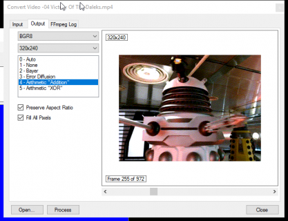

Almost got my video converter front-end for ffmpeg ready. Final testing phase and a few additions.
Must admit I tried the BGR8 8 bpp mode and was surprised that it has quite good picture quality for 1/2 the size of RGB565 format. With the correct dithering there really is not much difference when viewing animations on a small display however having to grab 1/2 the number of bytes per frame is a great outcome. Also, because there is only 256 possible pixel combinations a quick lookup can be made to convert BGR8 -> RGB565 to avoid heaps of bit shifting every pixel.
Couple of screen shots below. Tested on many inut files including avi, mp4, mkv, mov . Animated GIF files had one small problem... FFMPEG PROBE won't return the number of frames so I left that as a todo for later.
Has options for keeping the aspect ratio and if kept whether the device screen dimensions should be fully filled and thus output cropped.

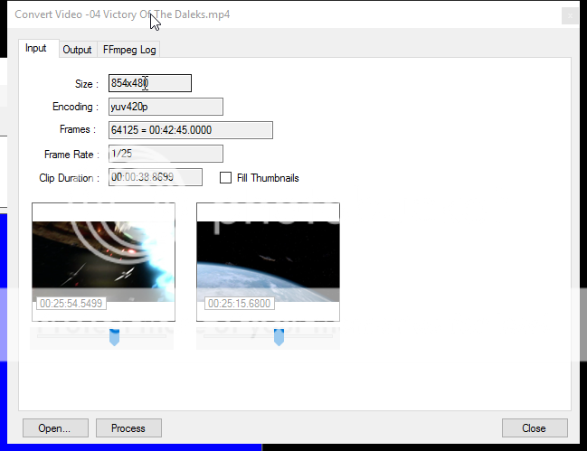

Finally got a release out. New version 2.0 of MCU Resource Maker has the video conversion utility built in. Had to get a new site as FFMPEG blew the size of my setup over the 10MB limit of the last one. When creating frames gives a few choices for audio (including none) and the video rate can be changed.
The file is saved with the standard header [header][video#1][audio#1]........[video#n][audio#n]
Audio is 8 bit unsigned mono, video can have numerous formats... but all uncompressed.
New site address https://kiweed-software.000webhostapp.com/
Screenshot of newest version of the video convertor.
