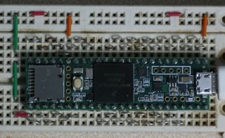

This problem started similar to posts about the program loader not responding such as https://forum.pjrc.com/threads/40313-Power-restart-on-Teensy-3-6 and https://forum.pjrc.com/threads/37531-T_3-6-acting-oddly-Program-Button-doing-a-reset-no-bootloader-reprogram but has gotten worse. After much hassle with the program I was trying to debug I wrote this program to narrow the issue.
It loops around saving the I/O values and if any changed since the last loop prints out all the pins monitored:
All the I/O pins are connected to ground like this:
The results I get when holding by the white proto board ends and mildly torquing back and forth look like this:
Pins 26, 27 and 39 occasionally go high and sometimes stay high. I have verified with an oscilloscope that the top pads on the pcb on these pins never glitch so the problem is in
the board or the chip connections, not the proto board connection. Also twisting in the direction of continuity allows the boot loader to run correctly, otherwise I get a reset when pressing either the Arduino upload button or the switch on the board.
No twisting is required if started from cold and waiting.

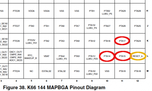

Looking at the I/O locations on the chip the affected pins are:
The red ones are for sure, the yellow, RESET_b, I''m speculating on since I don't understand the interaction of the MKL chip with the pin.
