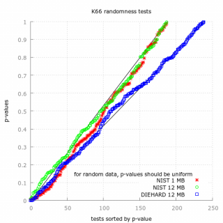

To visually observe 32-bit random numbers and "determine their randomness" is a fool's errand. You need to run statistical tests over millions of bytes of the random bits (see post #6). Maybe just observe the the low order bit (odd vs even). Here is a sketch that does a weak real-time statistical test of the random bytes.trng() seems to return values greater than 1e9 only

For crypto strength, NXP suggests that the entropy from the 32-bits is really only worth about 1 -bit, so if you needed an 8-bit random number, you would call the hardware RNG 8 times and take only 1 bit from each call.
F_CPU == 240000000 F_BUS == 60000000 1000000 trng() calls millis == 4266
4687812 bytes avrg 127.484650 entropy 7.999966
0.499969 0.499705 0.499510 0.499709 0.500060 0.500247 0.499891 0.499904
9372492 bytes avrg 127.496246 entropy 7.999980
0.499627 0.499808 0.499694 0.499999 0.499889 0.499783 0.500111 0.499999
14057184 bytes avrg 127.503380 entropy 7.999986
0.499836 0.499766 0.499733 0.500013 0.500028 0.499845 0.500095 0.500026
18741880 bytes avrg 127.505615 entropy 7.999991
0.499778 0.499804 0.499788 0.500079 0.499975 0.499886 0.500127 0.500019
23426580 bytes avrg 127.506622 entropy 7.999991
0.499829 0.499845 0.499809 0.500012 0.499976 0.499955 0.500212 0.499969
28111280 bytes avrg 127.507240 entropy 7.999993
0.499851 0.499872 0.499903 0.499988 0.499964 0.499885 0.500207 0.499993
32795980 bytes avrg 127.510254 entropy 7.999993
0.499796 0.499900 0.499938 0.500000 0.499978 0.499870 0.500199 0.500021
37480680 bytes avrg 127.507889 entropy 7.999997
0.499848 0.499843 0.499983 0.499969 0.500019 0.499866 0.500176 0.500011
F_CPU == 240000000 F_BUS == 120000000 1000000 trng() calls millis == 2133
7718948 bytes avrg 127.520798 entropy 7.999976
0.500197 0.500092 0.500216 0.500200 0.500287 0.500074 0.500177 0.499997
15432424 bytes avrg 127.503799 entropy 7.999989
0.500111 0.500096 0.500214 0.500055 0.500128 0.499946 0.500098 0.499966
23145864 bytes avrg 127.510590 entropy 7.999995
0.500093 0.500048 0.500210 0.499964 0.500083 0.500008 0.500114 0.500007
30859064 bytes avrg 127.504814 entropy 7.999996
0.500088 0.500044 0.500124 0.499950 0.500018 0.500070 0.500111 0.499961
38572636 bytes avrg 127.501213 entropy 7.999997
0.500035 0.500060 0.500071 0.499984 0.499987 0.500033 0.500058 0.499971
46285988 bytes avrg 127.502007 entropy 7.999996
0.500046 0.500106 0.500084 0.500021 0.500002 0.500044 0.500066 0.499966
53999544 bytes avrg 127.499855 entropy 7.999997
0.500019 0.500095 0.500083 0.499987 0.500006 0.500037 0.500068 0.499951
61712860 bytes avrg 127.505417 entropy 7.999997
0.500027 0.500111 0.500095 0.499998 0.500039 0.500036 0.500089 0.499979
