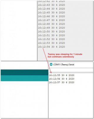

Hello everyone,
I'm having problems with the T3.6 RTC in combination with the Snooze library. The RTC works fine with the "TimeTeensy3" sketch and keeps the time even when unplugged from power using the battery.
But when I'm trying to retain the time when the Teensy is waking up from hibernation, it continues with the time it went to sleep (see screenshot).
What am I missing?
My final goals is to put the Teensy into sleep over night and wake him up in the morning. For this I'm using the TimeAlarm-Lib for setting a repeating alarm and the "alarm.setRtcTimer" function from the Snooze library to set the sleeping time.
In the example code you'll find the current test settings as well as the settings that will be used in production mode.
Thank you for your help,
Martin

Never used alarms so I'm not sure this suggestion works; anyway, you could try resyncing the time library with the Teensy 3.6 RTC every time you wake up from hibernation:
setSyncProvider(Teensy3Clock.get())
Thank you for your tip. I thought about this too, but I'm missing a function, that is called when the Teensy wakes up. I already figured out, that the setup part is skipped and the program is continuing in the loop. But calling "setSyncProvider(Teensy3Clock.get())" here isn't making any difference...
A couple of things that stand out is that you do not need the Timer driver just the Alarm driver. In the included sketch I also use the USBSerial driver to aid with printing to the Arduino Serial Monitor. You have to call setSyncProvider(getTeensy3Time) after waking. I tested it and it works, please download and use the latest beta Snooze library (either clone it or download the zip file) so we are on the same page, the latest is still beta but should work better than older releases but I'm waiting for any bugs to be reported before making an official release update. What I see in this sketch is that the the rtc updates it's time accounting for the the time sleeping also that is printed to the Serial Monitor.

Yeah brilliant, thank you very much, this works for me and helps me a lot for the upcoming todos. The timer driver was a leftover, but thanks for the hint ;-) I missed the point, that the program is continuing right after the Snooze.hibernate call. Nice one!
Have a nice day and take care,
Martin
