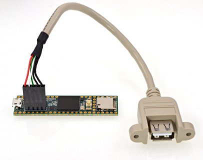

I am still wondering the first part is still something simple, like the USB connectors are not making good contact. I have had that in the past with some of the USB (5 pin PC USB expansion connectors). Where it works well on some USB devices but on others I would have issues. Sometimes it helped when I swapped USB cables. Often times it worked better with boards I have where I have USB connections directly on the board. Again sometimes helps when I put a Hub between them...
Again in all cases like this it might help if you showed a picture of your USB setup, in case something obvious can be spotted. Are you using something like:
So when I get nothing from plugging in a USB device. I usually start to do some simple debugging, like rework my USB connection. Things like touch up the soldering of the USB connector on the T3.6. Also check for any solder bridges. Make sure the connections are tight to the pins if you are using one of those
Might check if there are wear spots and/or tarnish on some of the connector pads and sometimes helps to do something to clean them. Likewise I have had some luck at times trying different cable to plug into them.
@Paul - With these 5 pin connectors, are there any devices that somehow do something different between the GND pin and the Shield? Like does anyone do something like have an IO pin connected to shield, maybe weak PU resistor to detect when it is connected up to USB? Again wondering different ways these touchscreens are detected versus other devices.

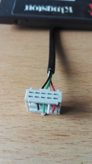

I have only 4 wires on the USB cable, the mass is connected to the 4th pin of the 3.6
As Pins 4 and 5 are connected on th TEENSY 3.6.
Here is my connector :
Sorry, maybe Paul has better idea of how that Wire/connector works. That is how does this connect up to the device? Does the Host side of an extension cable some how plug into the crate looking end? If so I assume that it is not making any connection up to the shield of it? Does it make a difference if you somehow connect up a ground wire up to the shield of that connector?
Again don't know how that one works.
