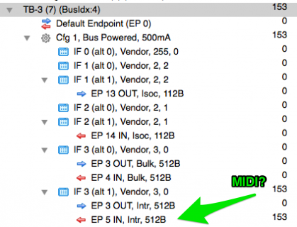

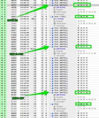

You could try capturing the communication while sending a small number of well known MIDI events. Maybe start with just note-on and note-off?
First things required to use external keyboard are drivers. I have never seen a USB MIDI keyboard that would have drivers for Linux included in it’s package. That’s not surprising, since nobody would need them. It turns out that ALSA manages to communicate with 100% USB MIDI controllers! The trick is that MIDI over USB is a common standard that every single USB controller uses. Therefore, since ALSA supports that standard, Ubuntu users need no additional drivers to use such keyboards. Just plug it in a free USB slot and ALSA will immediately discover it. Well, it won’t display a message, but you can ensure it has found the controller by running aconnect -i which lists all readable MIDI ports – your controller’s name will be included in the list too! (By the way, that makes me wonder why does other systems needs drivers for that…)

I only find functions for receiving/handling midi messages from usb midi devices..
There currently isn't much documentation for USBHost_t36, other than reading the USBHost_t36.h header file or looking at the examples in File > Examples > USBHost_t36.
But I can tell you the recently update put all the same functions in host mode. So if you create a "midi1" instance (again, see the examples) then you'd use midi1.sendRealTime(midi1.Clock). Of course this does nothing (but is safe to do) when no device is connected.
You'll probably create 11 device instances and call sendRealTime(midi1.Clock) on all of them. Should be pretty easy.
