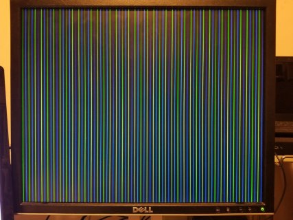

unfortunately, that's the case already and does not help.
https://github.com/qix67/uVGA/blob/master/uVGA.cpp#L986
But please read the comment:
// let's also give the highest priority from DMA to RAM and GPIO in crossbar switch
// master 2 = DMA
// slave 1 = sram backdoor
// slave 3 = GPIO
// when only the CPU requests access, this has nearly no effects
// Kinetis Reference manual says 6 is the highest priority but AXBS_PRSn register description says 0 is the highest
// I assumed 6 is correct but wathever I chose, I see no difference during my test
#if defined(__MK64FX512__) || defined(__MK66FX1M0__)
AXBS_PRS1 = 0x05432610; //0x06543021;
AXBS_PRS3 = 0x05432610; //0x06543021;
#elif defined(__MK20DX128__) || defined(__MK20DX256__)
AXBS_PRS1 = 0x00002310; //0x00003021;
AXBS_PRS3 = 0x00002310; //0x00003021;
// to gain 1 more cycle, when RAM and GPIO port is not used, attach them to DMA and for a fixed priority
// with this tip, DMA gains a lot of time... really a lot due to fact the frame buffer must be copied byte by byte.
// This type of copy waste a lot of bandwidth/time, so much it is not possible to trigger copy using a timer to obtain a more accurate pixel
AXBS_CRS1 = AXBS_CRS_ARB_FIXED | AXBS_CRS_PARK_FIXED | AXBS_CRS_PARK(2);
AXBS_CRS3 = AXBS_CRS_ARB_FIXED | AXBS_CRS_PARK_FIXED | AXBS_CRS_PARK(2);
// when DMA uses RAM, it cannot be stopped... but it should already be the default settings.
AXBS_MGPCR2 = 0x00000000;
// all other masters must wait, even during undefined length burst
AXBS_MGPCR0 = 0x00000001;
AXBS_MGPCR1 = 0x00000001;
AXBS_MGPCR3 = 0x00000001;
AXBS_MGPCR4 = 0x00000001;
AXBS_MGPCR5 = 0x00000001;
AXBS_MGPCR6 = 0x00000001;
// give absolute priority to DMA on SRAM_L and favor DMA on SRAM_U
// this final settings greatly improve pixel sharpness and line stability under heavy graphic load
MCM_CR = (MCM_CR & ~(MCM_CR_SRAMLAP(3) | MCM_CR_SRAMUAP(3)))
| MCM_CR_SRAMLAP(3) | MCM_CR_SRAMUAP(1);
Is it possible that there's a bug somewhere ?
