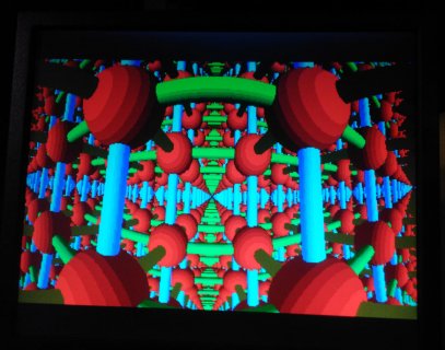

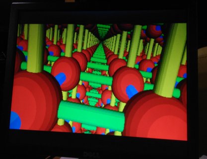

I also add a new 240MHz demo (puls) using such a modeline. The demo is a bit slow (~ 2 fps) because it uses a lot of floating computations and I think little teensy is a bit too underpower to perform realtime ray casting
This demo also uses a double buffering with a DMA channel copying the offscreen buffer to the frame buffer.
It is possible to activate fish eye mode by uncommenting #define FISH_EYE_LENS line.
