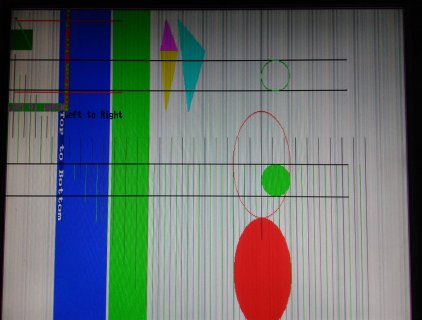

Hi qix,
I have a solution for my usb-host problem, I think.
I add two more channels to the FTM with modified timing. They have interrupts enabled and let me en/disable the usb-host thing and read gpios (gpio-access causes flicker, too (same periphal bus))
What do you think ? Does this make sense, and do you know a better way?
Edi: I greatly under-estimated the needed communication to the keyboard. Keypresses have a little lag now, but that's the maximum time to enable USB - a bit more causes flicker, again...

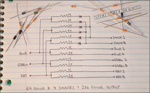

Somehow I missed this post !While googling to find a solution to my flexbus latch problem, I find an interesting page.
Instead of encoding pixel in RGB332 (RRRGGGBB), it is encoded in RGBI2222 (don't know if the term exists). Each component is encoded on 2 color bits +2 intensity bits. All components shares a common "intensity". No need to modify the library to use this mode, only wiring should be adapted
Technically, each pixel can only contains 64 colors but each pixel can use a different intensity. Technically, it is 64 colors sharing intensity among 4096 possible colors.
