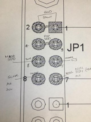

As per the Sumotoy header, I have connected pin 2 to CS, pin 7 to SDI / MOSI and pin 14 to SCLK. SDO on the display is unconnected.

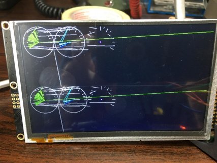

Then I went back to the forked library and tried the gauges sketch. That appeared to have no clock either but after a few reboots, it started to draw on the screen but that is all. Clock had started but went high just after. I tried the Mandelbrot sketch but just had some random colour spots.

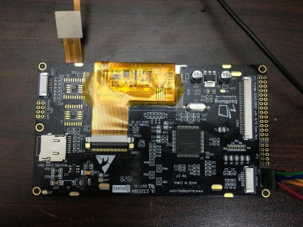

I have pulled my hair out on some of these. One I messed up on and did not have the 5v VR on it... Always flaky, so I got a VR and soldered it on, plus a few caps and changed the jumpers...
Also mine came configured as SPI3 not SPI4, (first one), So I needed to update the solder jumpers on back.
So another thing I would suggest is to double check yours to make sure all of the jumpers are correct.

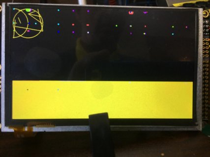

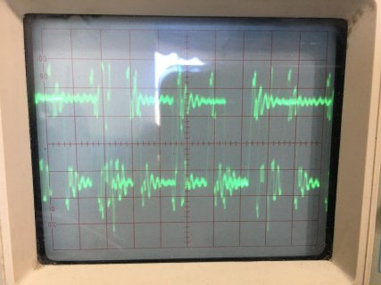

And in cases like this it might help to post images of your setup. This one ran fine right now for me on one of their T4.3" displays with T4.
I am running latest Arduino and latest Teensduino +++ and the library version mentioned.
I have the latest or at least a very recent build of the IDE. I removed the RA8875 library from the included libraries because it was being selected for compilation rather than the t4 library. It compiles correctly according to the debug information.

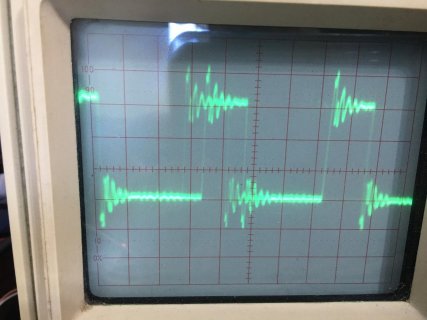

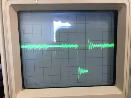

The images show a variety of screens after a reboot. The 'scope traces are pins 10 to 13 and all look realistic to me. At the time, the display was a white screen.
I have stripped away everything else that was connected and just have it running from the USB port.

A few more images and the connection diagram from their datasheet...
The 'sillyscope' traces...
Did you try the begin with: RA8875_480x272 and see if it makes any differences?
Also did you verify the jumpers on your display match the ones for SPI 4 wire?
Edit try slowing down the SPI speed. These displays are very temperamental to signals...
No difference apart from the (corrupt) image being smaller. Still the same random selection of different screens. This is what I ran...

Your code runs on my display once I change pin numbers to match mine. Might help to hook up reset pin.
Also again these displays are sort of picky on signals. So I had better luck once i moved to an RPI like connector that the display plgugs into.
You might try other jumper wires to make sure they are seated well. Sometimes on ones plugging into display I would try things to get them to make better contact. like unplug, use a needle or like to push in the area within the break in cover (tab) and then plug back on pin hopefully making it tighter.
Other than that not sure what else to suggest
EDIT: On interrupt pin, I believe that is an optional pin that can be configured to be used, to have the display let know things... Like instead of us doing a query of the display to see if an operation has completed, I believe the system can be configured to interrupt you to say its done,.
FWIW, I've had other displays that worked better when I threw out the cheap jumper wires and went to better jumper wires and/or cut my own solid wire connections.
I've also had to throw out breadboards where over time one or more connections became unstable.
And I seem to routinely have to redo solder connections that aren't always stably connected. This last happens a lot in costume parts where the movement of the Teensy in the costume will break the solder joint.
In general, try to keep your wires as short as possible. And some places just have a lot of electrical noise.
Another thing to check is whether your CS pins have pull-up resistors. This can help particularly if you have two different items on the same SPI bus. I had one setup with the Teensy Animated Eyes setup (2 displays on the same SPI bus) where it worked a lot better when I included pull-up resistors between each of the two CS pins and 3.3v (I would typically use 2.2k resistors).
Finally, some displays just can't run as fast, and you may need to experiment to find the highest SPI bus speed that the display will tolerate. Even two displays from the same manufacturer might have slight differences in the maximum bus speed.
Thanks both. I will have another dabble but I am getting convinced that the board is faulty, so have emailed the seller for their comments.

Today I have been able to start modifying the software to suit the new display. I have tried al the options for the pins and it has made no difference to an issue of possible incompatibility. The program starts to run and then appears to crash every time before it starts to look for input from the outside world. The original OLED display works fine and does not use the SPI library, but the 5" does require it and will not compile without it. I am really scratching my head over this one. I wonder if someone could take a look and tell me where I am being dumb please? ;-) Software attached that doesn't work.
It writes the startup screen, then writes the headings and the two lines. After that it goes unresponsive.
