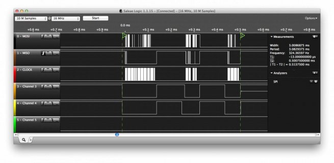

It may be hard to get CC3000 to move data fast. First, the CC3000 indicates "ready" via the IRQ signal, so you can't just start streaming SPI data at it. Second, there are a lot of command-and-control bytes sent for each UDP transmission, and a bit of handshaking as well. Below are snapshots of a UDP echo -- teensy sends 8 bytes and gets 8 bytes back.
The SPI clock is running at 8mhz. The time between the end of transmit and the start of receive was 3.013ms. Channel 3 is CS, and channel 4 is IRQ from the CC3000. In the first (transmit) png, the third SPI event is the recvfrom() request to the CC3000. The logic analyzer data is actually from a run on a mega2560.
SPI DMA should be possible (or fast SPI) and in fact the TI has logic analyzer snapshots of SPI with DMA in
http://processors.wiki.ti.com/index.php/CC3000_Serial_Port_Interface_(SPI)
and that document suggests 4mbs should be possible with 8mhz SPI. SPI is spec'd to 16MHz so faster might be possible.
