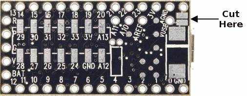

The simplest way is to just cut the pads apart on the bottom side, as shown on back side the reference card. Then you can connect 5V to VIN. The USB will be unable to power the board.
If you want the diodes to allow either, then solder a diode between those cut-apart pads, or between the VUSB and VIN pads. The cathode (side with the stripe) connects to VIN. Use a diode between your power supply and Teensy3, also with the cathode connected to VIN. With the 2 diodes, the Teensy3 will get power from either source, but neither can feed current back into the other.

There are two pads on the backside ..Do you cut them both on the Teensy3 ?.......and ...If I power up with a 5v external can i still load the sketches via USB...and...will i pick up 5v output now on the 3v pins
Tks Mike
Yes.
No. The outputs will still be 3V. If you check the Teensy3 schematic, this change just disconnects the 5V from USB and powers the board from your 5V at VIN. Everything else runs exactly the same way.

It you don't cut the pads apart, then VIN and VUSB are still connected together. If you ever connect external 5 volts and a USB cable at the same time, the USB could attempt to feed current into your 5V power supply, or the power supply could attempt to drive current back into your computer. Neither of those is a good thing. Which direction the current flows depends on which has higher voltage. The current does go through the 500 mA PTC "fuse" (which is really only a resistor that increases in value when it gets hot from too much current), so that does help limit the opportunity for damage. But still, it's not good to allow 2 power sources to attempt to drive each other. That's why Teensy3 has those pads, so you can cut them apart for these types of situations.
