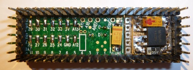

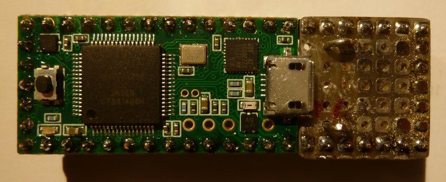

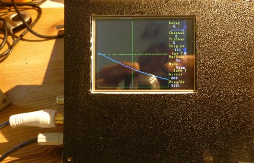

I have made an Dual-Osci with teensy3.1 and a 4.2" touch display:
http://http://forum.pjrc.com/threads/25532-ADC-library-update-now-with-support-for-Teensy-3-1/page4
I had some problems to connect the 16 display-pins (d0..d15) with the teensy-pins (most of them on the backside).
