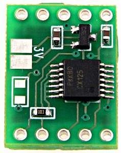

The very first thing to do is solder the 3V pads on the bottom of the MicroSD adapter.
This is because Teensy 3 = 3.3v, while other/older Teensy's are 5v.
The MicroSD adapter can work at both voltages, all that is required is to connect 2 pads together to set it to 3.3v:
Here is my attempt (my first soldering ever!):

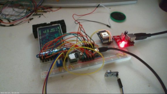

MicroSD wired up to Teensy:
+5V goes to 3.3V (red wire)
Ground goes to GND (black wire)
MOSI goes to pin 11 (blue wire)
MISO goes to pin 12 (green wire)
SCLK goes to pin 13 (white wire)
SS goes to pin 10 (yellow wire)
Additional warning, with thanks to LarryP:
When you connect the MicroSD adapter to the Teensy, take into account which direction the MicroSD card holder is facing!
Take another look at the image above to make sure :)

A caution to people wiring up one of PJRC's microSD adaptors for the first time:
before applying power, double check the orientation of the adaptor, particularly with respect to which end of the adaptor the card slides into. I mistakenly assumed (without thinking about it enough) that the soldered connections to the card's socket must be opposite the side that the card slides into -- and wired it up wrong, coming closer than I'd like to damaging it.
@Paul,
If you revise the SD Adaptor pin diagram, you might add an arrow showing which side the card goes into.
Thanks again ZTiK.nl !

Since I started my project I have been using a separate 3.3v+5v usb powersupply for all my modules with the exception of my speaker & MicroSD.
-The speaker uses a digital pin along with GND and the MicroSD adapter is the only thing connected on the 3.3v out pin.
-Then I have my TFT/GPS/Microphone/Humidity&Temp. sensor all powered by the 3.3v external power supply.
The powersupply is connected to the right-side (top in image) powerstrips with 5v, and with jumpers running from below the led all the way to the left-side powerstrip with 3.3v.
(So far I have no devices on the 5v yet, but this will change soon I hope)
